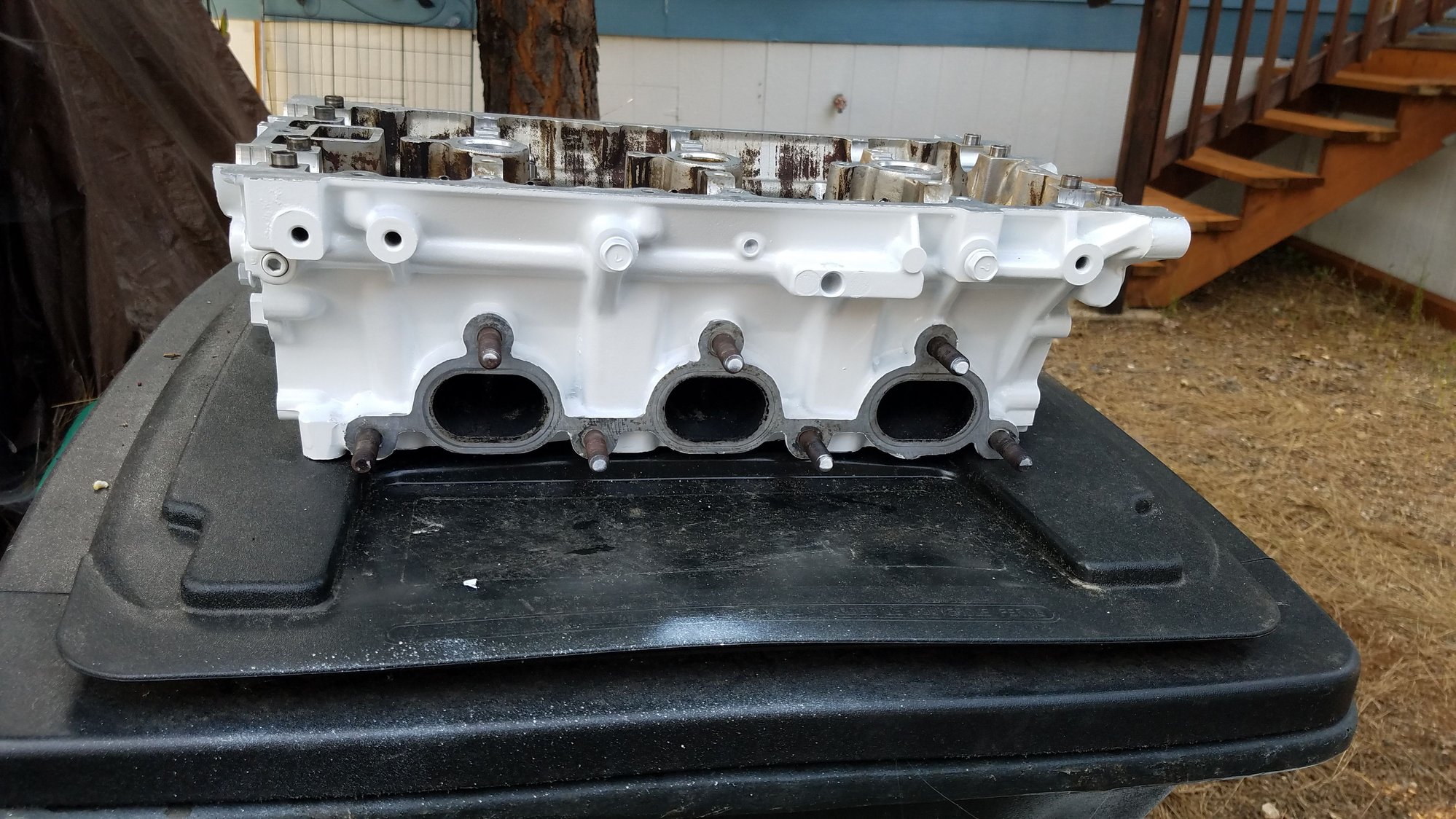

I pulled the heads on my twin cam because I couldn't source a tool to get the keepers out. I had to use the old C-type spring compressor, but upside down and using a 3/4 x 3" pipe nipple with a slot cut down one side, as an extension to reach into the head. It went really fast and I was able to change every hose on the engine at the same time. I'll post a pic if anyone wants.
As far as vla's, change them to the upgraded ones, $120 for the set of 24 at partsology.com.

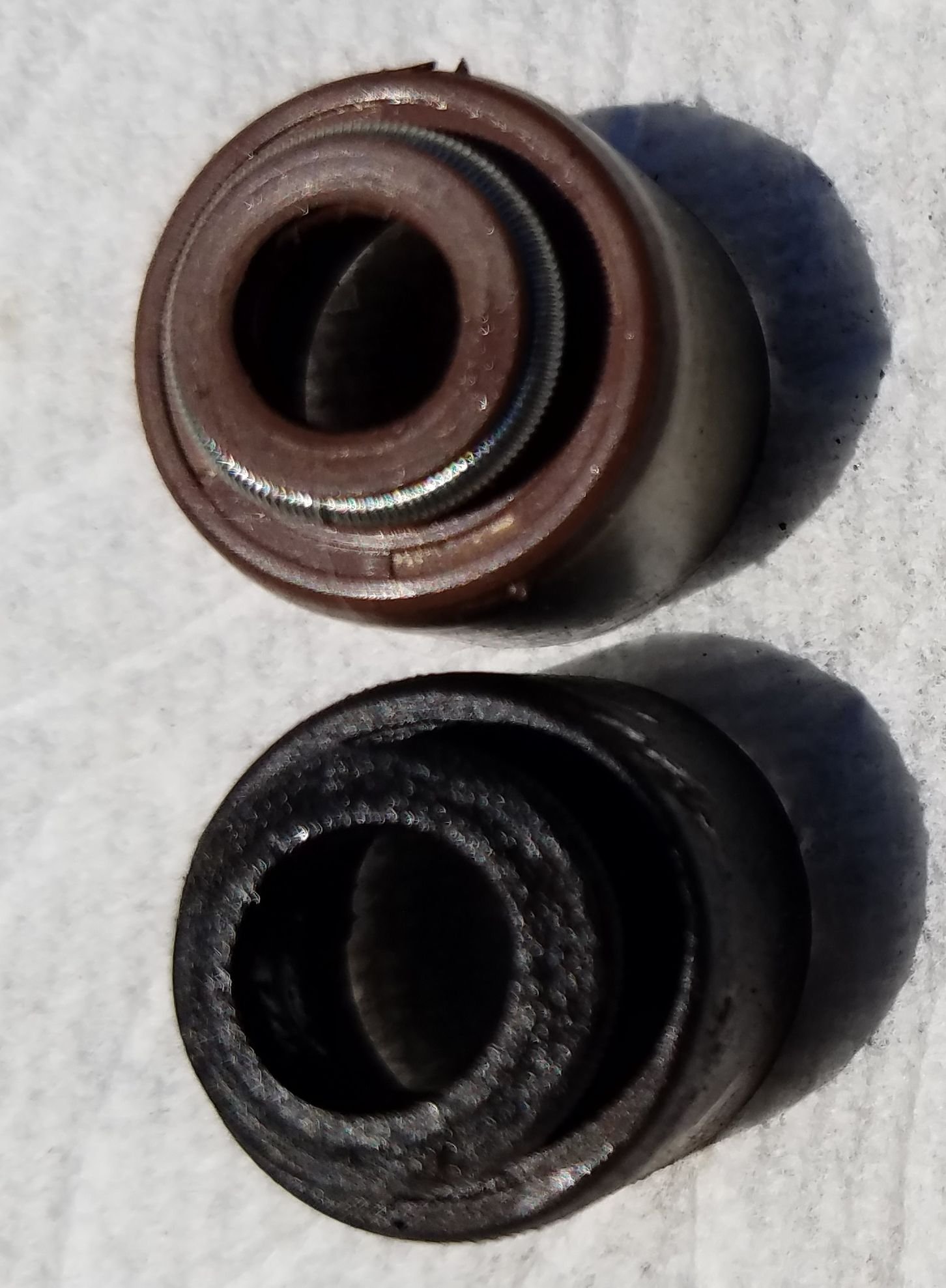

Hunter, I, in no way, meant to come across as criticizing you or second guessing your decision to keep the heads in place on your rig. I just was saying that I couldn't figure out any way to do it on my dohc, with the tools I had. It was no great struggle for me to pull the heads and figure out how to do the seals on the bench. An added benefit was that I could inspect the valves and guide fit as I went. Here's a fun pic of an old seal and a new one, needless to say, the valve stems were just wet with oil, lol!

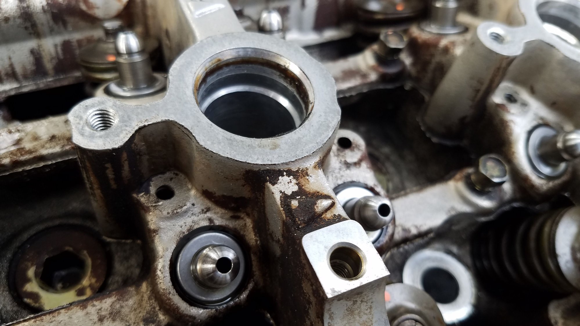

Marksroberts61's Avatar
Joined: Mar 2019
Posts: 60
Good look at upgrade VLA's. Note how far below the rim of the head the valves are.
Cant even see the valve springs, and there's 12 of them in there!
Old Apr 9, 2019 | 03:00 PM
I can see what you mean by springs seating deep inside the head. Looks like the camshafts push on the rockers from above? This would definitely make it more difficult to reach the springs. I think the tool I used will still work, but on the bench work would definitely be easier. Thank s for sharing the photo.
