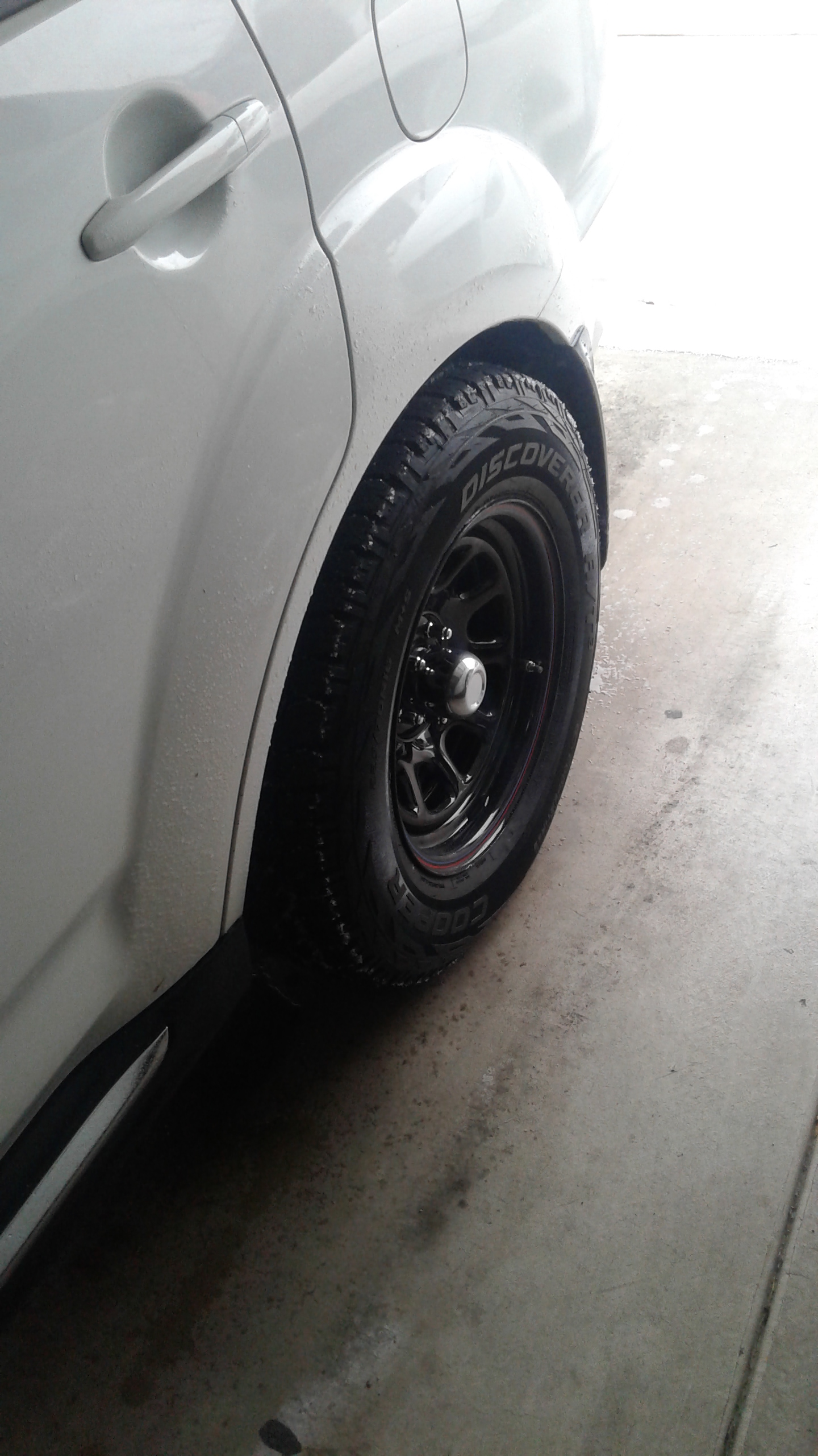

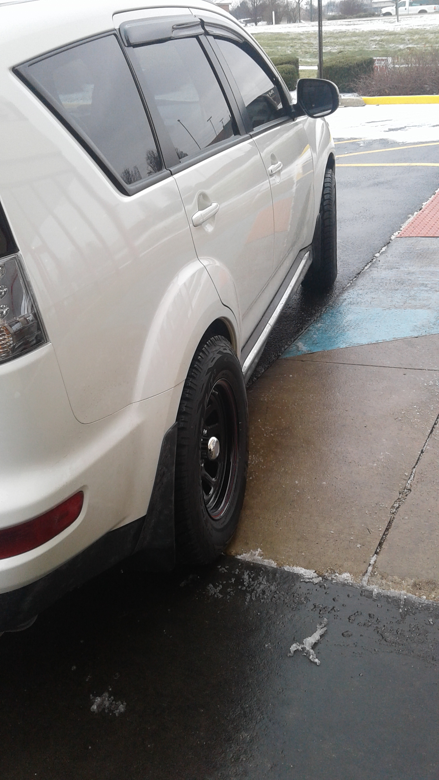

Default Outlander wheel/tire combination
Due to weather conditions here in the midwest (we had icy road conditions lately) I had to replace the stock wheels and tires which gives me a better handling. I did have the Discount tire installer test the wheel and tire for any rubbing during install it did turn out good no rubbing at full turning left and right. the steering wheel is much more easier to turn. Please make sure you take the vehicle for wheel alignment at your trusted shop.
Now I have Unique series 42 (part# 42-7712) Black w/Red & Blue Stripes "D" Window 16x7, 5x4.5, 0 offset, 4" rear spacing, 3.3 center bore, approx 33lbs wrapped in 225/70/R16 Cooper AT3 103T SL OWL ITEM: 27147 29 inches, wheels and tires at Discount tire. I choose Cooper over General Grabber due to road noise at highway speeds with only minimal noise at 70MPH. The stock wheel sensors were tranfered to the new steel wheels.
