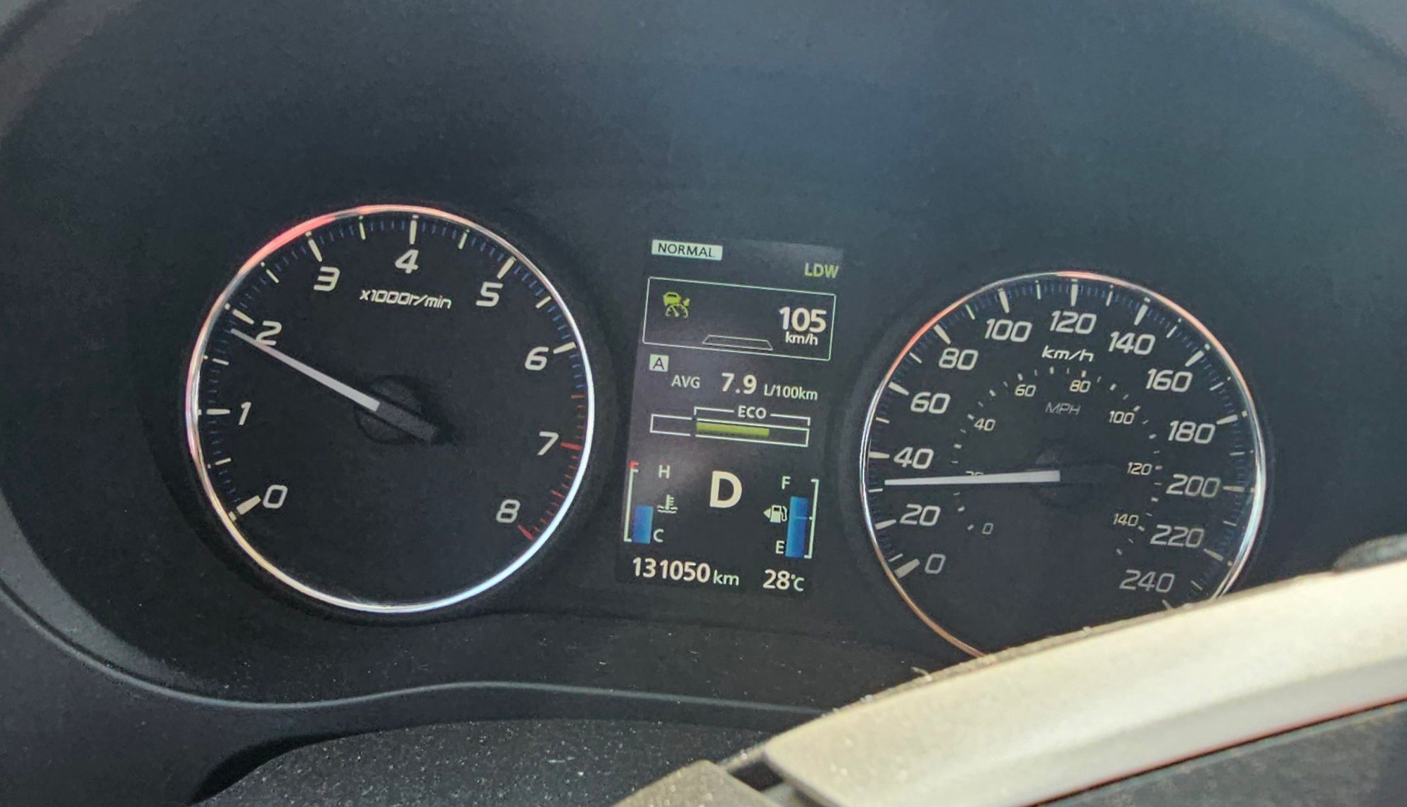

I have no options but to use the dealership I have. But here's the update. Guy working last week was an idiot. CEL was cat code. My warranty covers the manifold...but not the manifold with the cat attached 😒. Anyway they cleared the code and told me 2000$ for replacement...not without trying to get me to trade in first. Not gonna happen. So did a bit of research and just said f it. I grab a can of royal purple max clean. I am in Canada and we don't really have any cat cleaners. Dumped the hole bottle in and filled up. Drove to and from the lake just over 2 hours. And now she purrs like a kitten. I normally get 10.5-9.2 l/100km . 9.2 empty car no passengers. I had full load and all 3 of my kids both ways and dropped down to 7.9 so I'm sure it did something. She runs smoother, doesn't seem to be throwing off soon much heat . I'm gonna run another bottle after a normal fill of gas and see what happens. I am also confident that this was the cause of my coil injectors going due to excessive heat. I also got in contact with my extended warranty company that I purchased when I bought this veichle in 2013 and they sent me over a list of everything that is covered. Many things on this list that I have paid for as the dealership said it wouldn't be covered. But they did not bother to check. Specifically my sway bars front and back and links and bushings. Rear I have all ready replaced and paid for. Not the front needs to be changed told me the cost and told me that's not something warranty will cover. So if anyone purchased or purchasing extended warranty make sure you get your list of what's covered there's many things on there you think would not be covered but in fact is. Including your stereo and window switches 🙃

Sounds promising, let us know how it goes.
