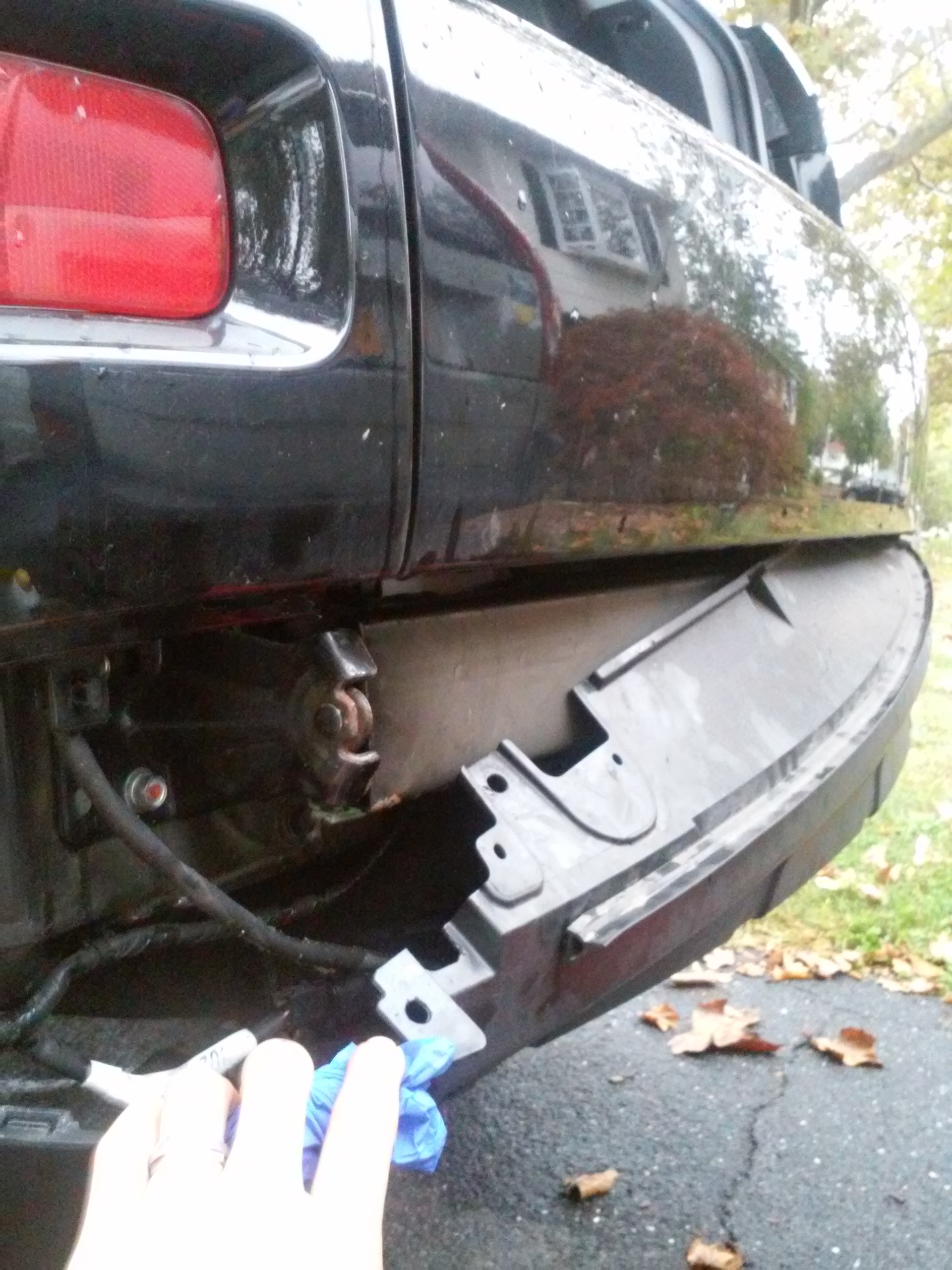

i asked mitsubishicars.com but got no reply.
just not a big fan of the exposed hitch assemblies...
probably a slim chance though coz that metal beam doesnt really look very
tough.
TIA for any info

yes! either the one you posted or the other guy turbo.
but damn, seems theyre quite expensive and only available in aus.
the oem US version we're stuck here with is this: MZ313809
i got a drawtite/reese below-bumper one for less than $150 shipped.
i was thinking maybe i could attach a bolt-on standalone hitch to the bumper (like on RVs), if the bumper was strong enough.

I used a Curt bolt on hitch receiver that was super easy to install, but I think there is a 2000 pound towing limit so my bolt on 2" receiver is a bit of overkill. I've had the whole rear dis-assembled before (to put in sonar back up sensors) and that bar didn't seem very sturdy to me

There is nothing on the back of the Outlander that will support any weight pull down on it. I have had the entire thing apart at one time or another. And I mean down to the pieces and bolts leaving just the frame with the inside removed too.
The bolt on is super easy and took me 20 minutes to install. The driver side is just three bolts to insert and torque down. The hardest thing is to get the muffler hanger off to position the passenger side correctly and then three bolts there. Just for good measure they give you a clamp that goes around the tow hook. This receiver literally becomes an extension of the frame.
Only full size pickups come with solid steel bumpers anymore and not even all of them have this option.
I have never towed a trailer with mine, but look forward to purchasing or building some kind of tear drop or retro camper in the future. Right now I have a three bike rack that fits nicely and comes with a tip back feature to allow the tailgate to open and I have one of those platform racks with a canvas bag for camping gear, hauling, etc.
