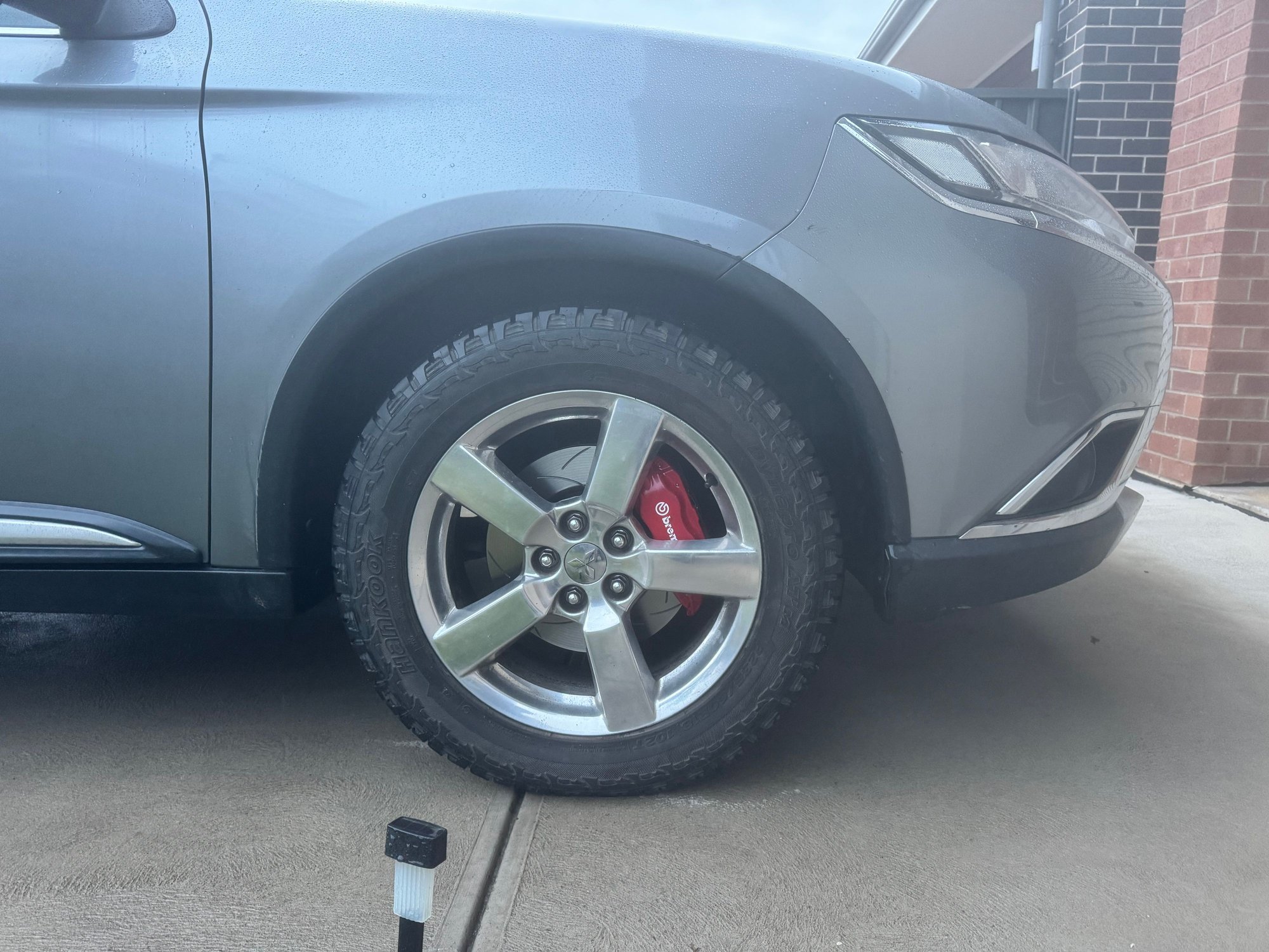

Hey guys forgive me if I am blind, I have someone wanting to achieve the ever threaded evolander build and wants me to do the work .
Iv spent hours on ASA looking at applicable models and bits etc but I cannot seem to find my answer..
What is the Turbo model Outlander/Airtrek's front brake caliper bolt hole centres please and the rears.
Or if anyone knows can I simply bolt brembo s on? Are they nt based on the Evo7 platform?

i have just installed a set of front 4-pot Brembo brakes from an Evo VII. to fit them you need to change the front knuckles and drives shafts (because Evo's are larger in diameter).
Usin the Evo knuckles the caliper is bolt-on directly and without adaptors (which I didn't want for the front brakes).
Stopping power has dramatically improved.
My intention is to fit the rears as well (using an adaptor), however I would appreciate anyones iinput on how he did.

forgot to mention that brakes will NOT fit inside the stock 17in wheels. Need to either fit the 17in from the Evo VII, VIII, IX or the 18in from the Evo X. I went for the later, with 235/50 R18.

Indeed sounds great.. I though I'd need to use the driveshafts,but did you use the entire shaft or simply only the outer cv with the knuckle spline on it?
I knew that the brembo won't clear stock rims , we now have HUzge 20" on it now
