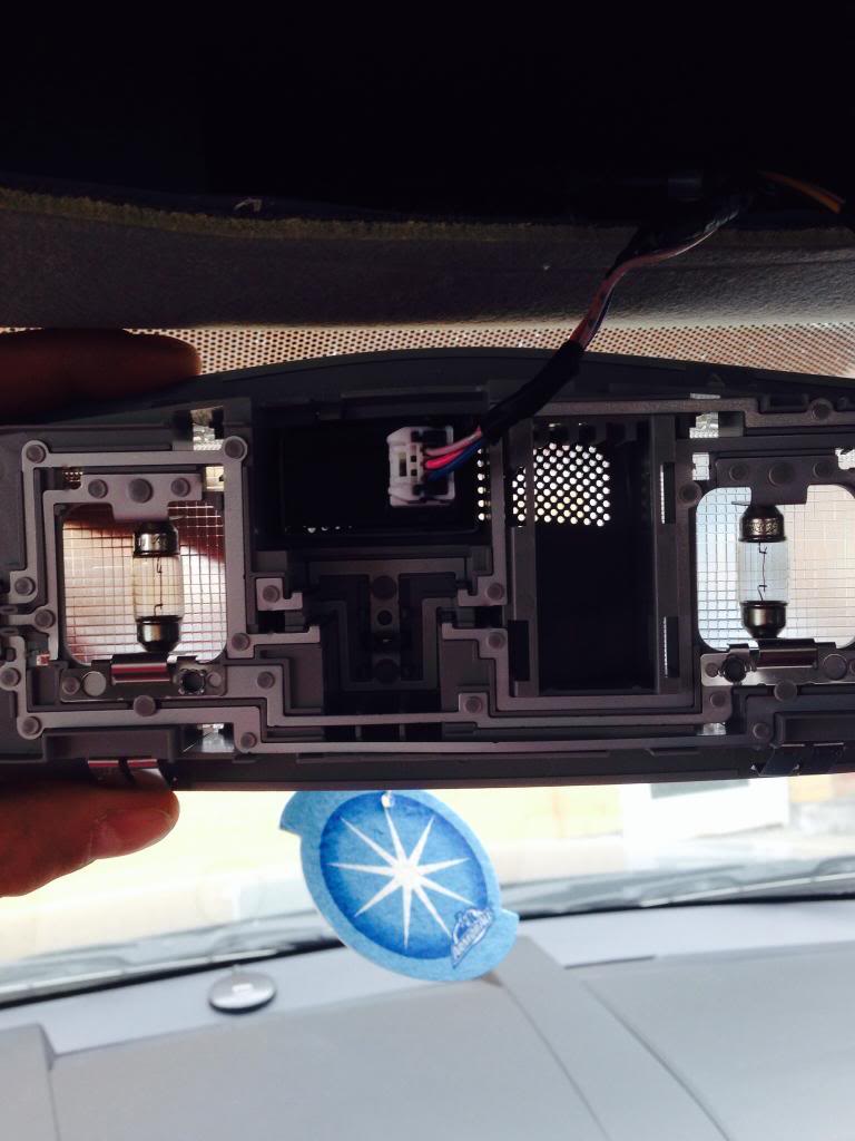

Old Mar 25, 2014 | 04:32 PM
Tyler.M's Avatar
Joined: Mar 2014
Posts: 15
Opened it up and this is what was inside is the black box there the mic?

Kinda dark, but it should be plugged into the white connector. I only say check here because when if you have to get a BT module, it comes as a kit with the mic. I just had to do this in February. My 09 ES Outi came prewired with buttons on steering wheel but no BT module. I ordered it and installed it myself.

Yeah the white connector is plugged into that black "mic" well thats good ill bring it to the dealership have them look into it
