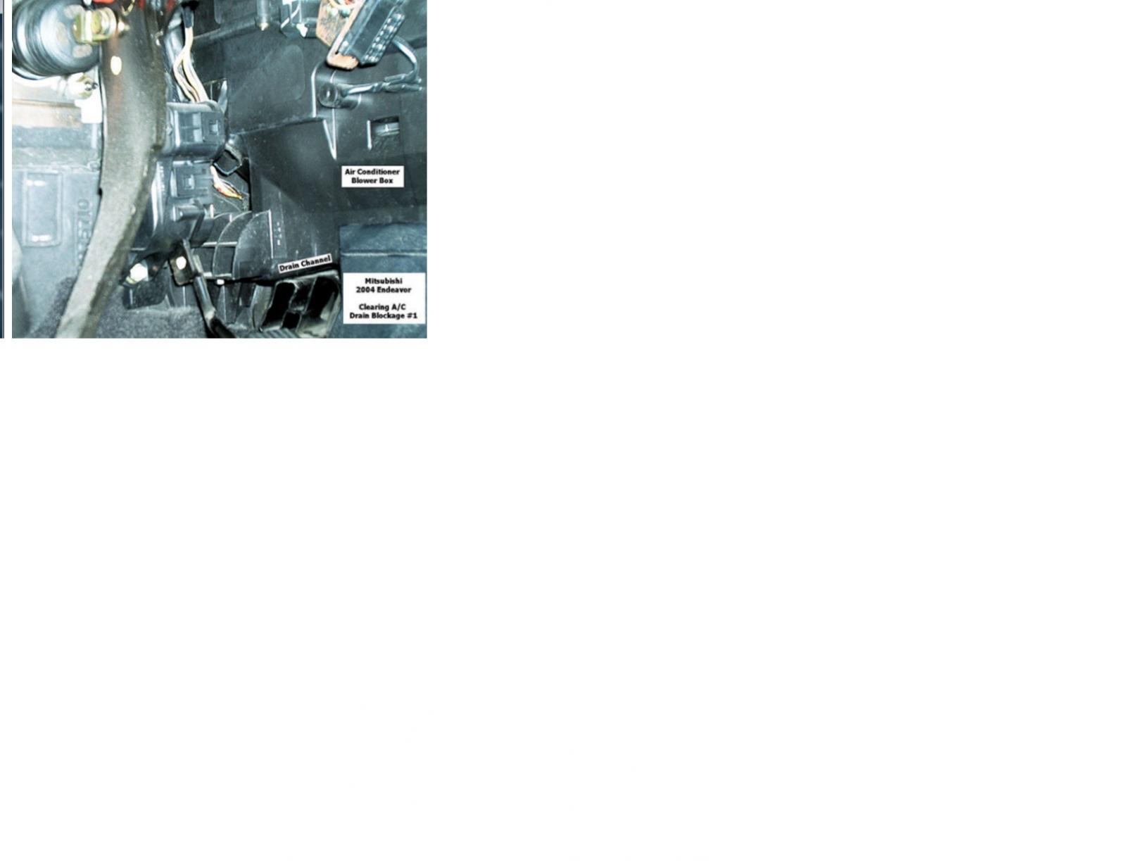

My 03 outlander has a plugged condensate drain and I can't find the drain or how to clear it. The condensate is overflowing into the carpet and i need to know how to clean the evaporator and clear the drain. Help please
Here is the service bulletin number but I dont know how to download the service bulletin.
Bulletin Number: 355008Bulletin Date: 20031001Category: 138110 VISIBILITYEFROSTER/DEFOGGER SYSTEM:WINDSHIELD:BLOWERSummary: DEBRIS (SUCH AS LEAVES, ETC) ENTERING THE FRONT COWL AREA MAY CLOG THE EVAPORATOR HOUSING DRAIN TUBE. IF THIS OCCURS, THE EVAPORATOR HOUSING MAY FILL UP WITH CONDENSATION AND OVERFLOW INTO THE PASSENGER COMPARTMENT, AND INTO THE BLOWER MOT

No suggestions yet. I found these pictures but don't know if they apply as they are from an Endeavor. Using these photo's I was able to find the exit. The only way to clear as the tube is too long is with a compressor and blow the clog back to the evaporator. This will not be a perfect fix

Hi, thanks for these pictures.
I have a 2005 Endeavor.
Are your puctures in the engine compartment, or underneath the plastic grates near the window?
I cannot find mine.
