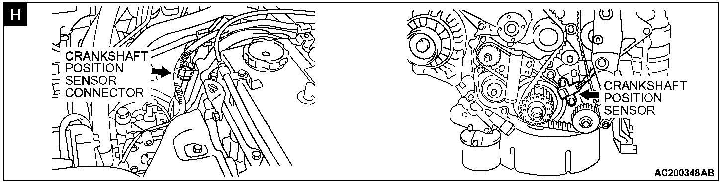

Old Aug 8, 2018 | 09:14 PM

Old Aug 8, 2018 | 09:24 PM
Le@r's Avatar
Joined: Jul 2009
Posts: 12
From: BLainville,Canada
RH lower side. hope it help

Le@r - Thank you Very Much! Fortunately, with ccernst's help I found the sensor.
Removed it last week, didn't test it but it has a strange bubble in the plastic near the bottom. Just received the new one and will be installing it this WE.
The picture is a bit off. The half-shaft (not shown in the drawing) is almost directly on top of the sensor.
