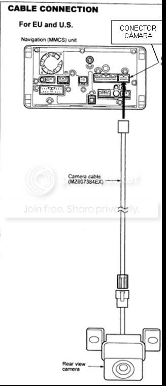

I do not have the '11 Outlander but as someone else pointed out earlier, the stock camera would be connected according to the diagram here:
http://i339.photobucket.com/albums/n...ectorcmara.jpg
This means it wouldn't have an RCA video out that you can connect to anything else. However, you can, I think, tap into the video and video ground wires in the stock camera cable and run your RCA cable out from there to channel the signal to wherever you want. Someone with a stock camera can confirm though. If this is indeed the case, the mitsu camera cable would most likely be found terminated somewhere in the dash where the MMCS had been. I understand that the backup camera is already in place and the car is prewired which would make it fairly easy. You should also be able to power the camera up from there. Someone mentioned it expects 6.5v but again, I am not sure about that. I'd first open up the MMCS area to find the 12-pin connector that goes into the MMCS camera input (you can see what it looks like in the very first post). If you can find that, you should be able to access the camera wires for signal and power.
What I've said is from my experience with the 08 Outlander, and hopefully not much has changed. Good luck.
