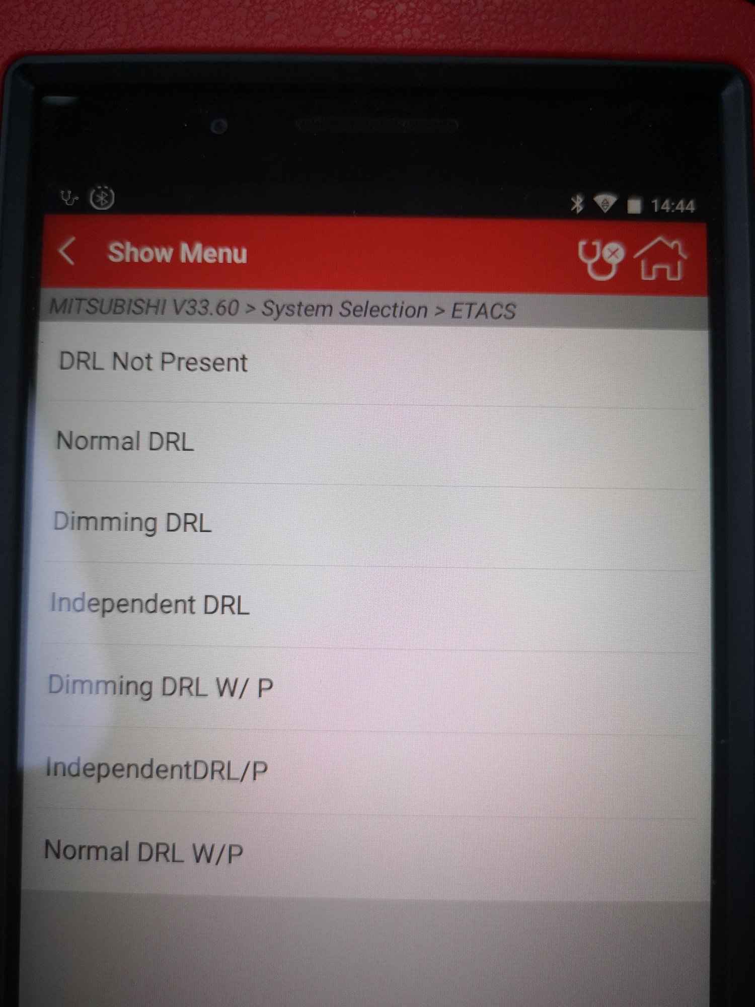

Although you did not specify your model, Mitsubishi vehicles have DRLs that are voltage modulated. When the DRL is on (either when low or high beam is used to carry this function, most Outlander Sport and Outlander models (except GT), respectively) the voltage oscillates between 0 and 12V with an average of 8 V or so. Halogen bulbs tolerate well this voltage modulation but the HID and LED bulbs burn out prematurely besides their annoying flickering. Resistors connected in parallel work well for LED turn signals to eliminate hyper flashing but they do not eliminate the flickering of DRLs as the source of these are different. If you want to keep your LED light you have to install an independent DRL and program the ETACS (either disable DRL or assign the foglight as DRLs but then you need to change the ordinary foglight to the kind like the #8 post here (which has two bulbs: one works as fog light and the smaller as DRL, this type of foglight was installed to the top models of Outlanders and Outlander Sports for markets, where DRL is mandatory). In the end there is no plug and play solution.

Mines a 2011 outlander. I seen the exact on my launch 431 pro so I'll look into what I can do about reassigning the drls.

Well I somehow managed to get the drls turned off. So now they're always on full power, if I turn it to the marker lights then the headlights go off and then I put it all the way forward they all come on like normal.
I tried the not present as well as indipendant but all flickered. It wasn't until I disconnected the battery as I was getting codes and errors https://mitsubishiforum.com/forum/mitsubishi-outlander-10/coding-not-completed-errors-such-54814/ that I turned the vehicle back on and now the drls are disabled.
