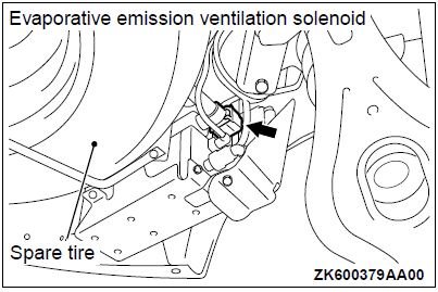

Hey guys. I just had my outlander in to have the drivers side upper control arm done and a couple days later the engine light comes on. The mechanic wanted to charge me a $90 diagnostic so i got the code read by part source for free. Its 0456 small evap leak. What am i looking at repair wise? Im hoping its just a hose!! Could the mechanic of set it off by taking the filler neck and some canister(i forget the name) out to replace the upper control arm? My first mitsu so im out of my league.....love the car so much but if it continues like this repair wise.........not cool!

edit: After reading another post of yours, sounds like you were only working on the rear of the vehicle...which the service manual does have an upper arm. The Evap cannister is close by, see the attached picture from the service manual. It would be possible that wires/hoses could still be disconnected or were damaged.
