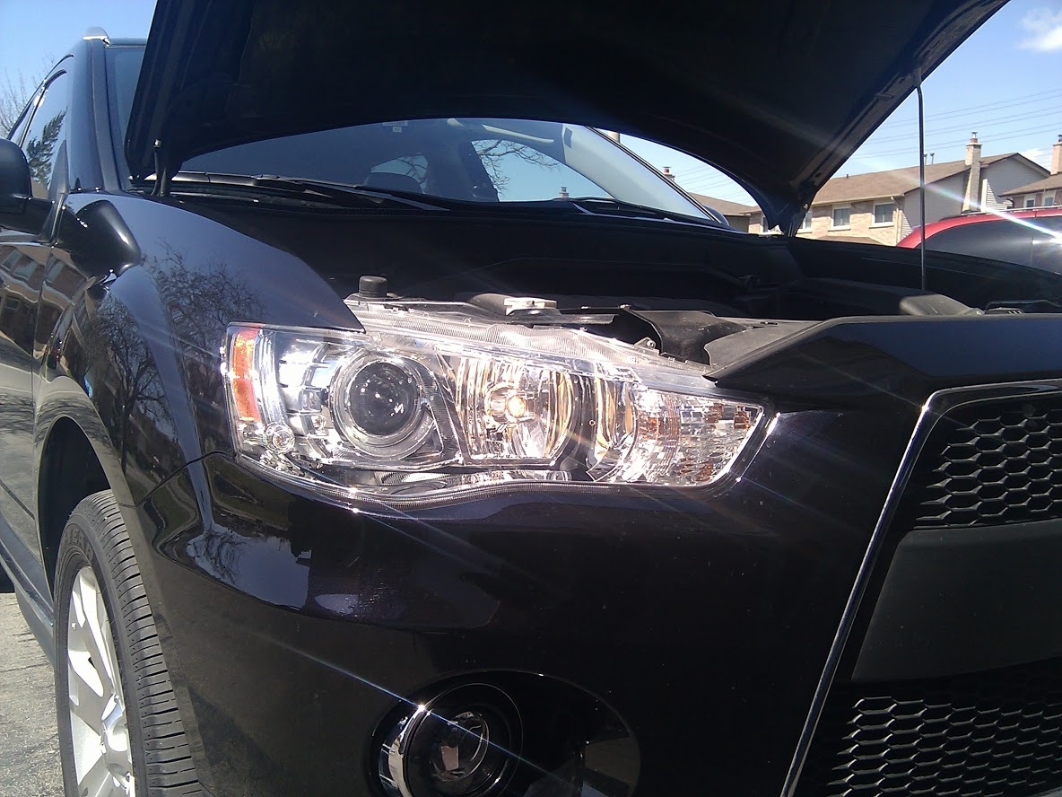

Independent DRL, this one is more complicated and my second theory was right. There are 2 connectors at the headlight, on my non hid headlights the smaller (6 pin connector but with only 5 wires) is plugged into nothing. With this setting activated the first pin of both left and right connectors (on my car left side wire is yellow and right side wire is blue) is powered during DRL operation, the 4th pin is always grounded(black wire).
So if you want fog lights or park lights or auxiliary led's or whatever as your drl's you then have to wire this to those lights. It's pretty cool that mitsubishi left all this wiring there, if you want to convert to oem hid lights all you gotta do is activate this setting and make sure both connectors are plugged in and it'll be like all the cars that came with hid from the factory.

Great post Alex, you got everything right.
Independent DRLs use dedicated bulbs/LEDs - on North American 2nd gen it's the middle segment between projector HIDs and turn signal.
