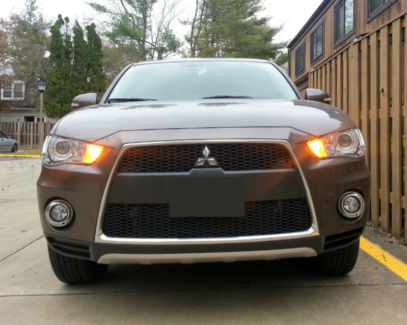

Of course, the cheapest and easiest way to add DRL functionality (and all of the benefits therein) is to add a logic module that operates your front turn signals full-time (except when they are blinking as signals). Turn signals meet or exceed all DRL output requirements, plus they're amber, which is more conspicuous in daylight than bluish-white LEDs. They're offered for a reasonable price here.
