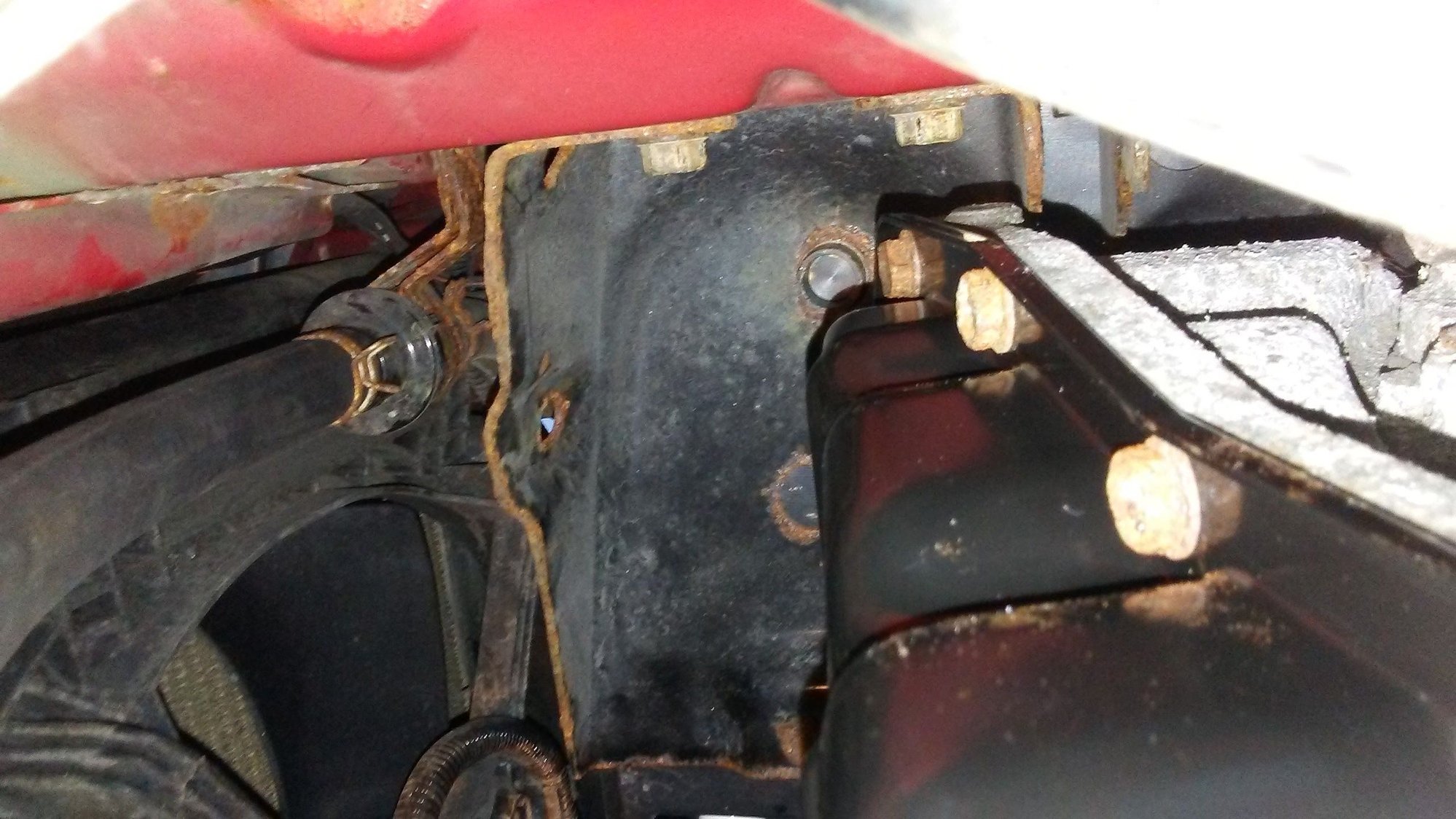

Antifreeze. You can trace it back to the radiator fill spout. If you're looking for something that rusts that carries ATF there's the ATF cooler tube though:
Power steering hose nipple is also something you should keep an eye on:

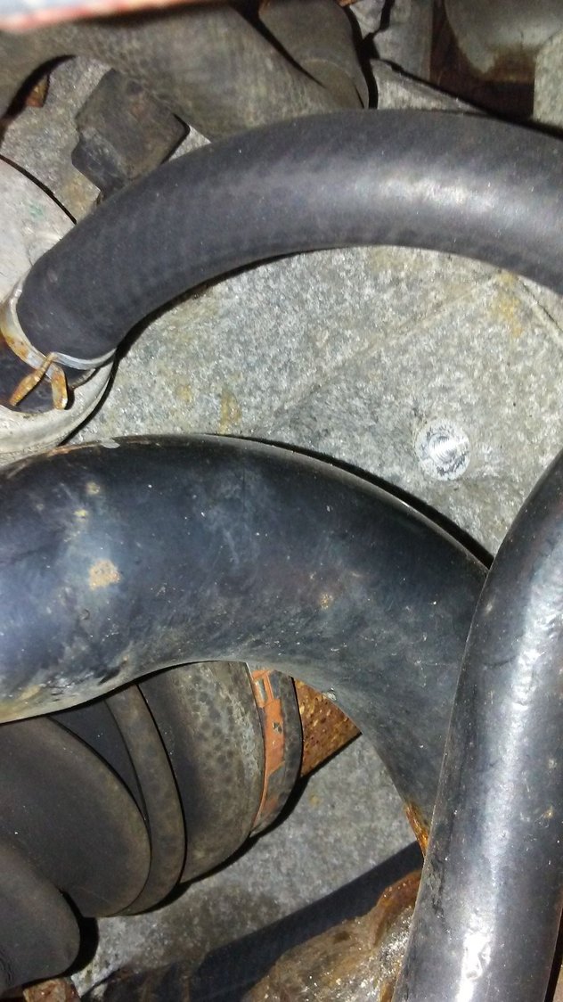

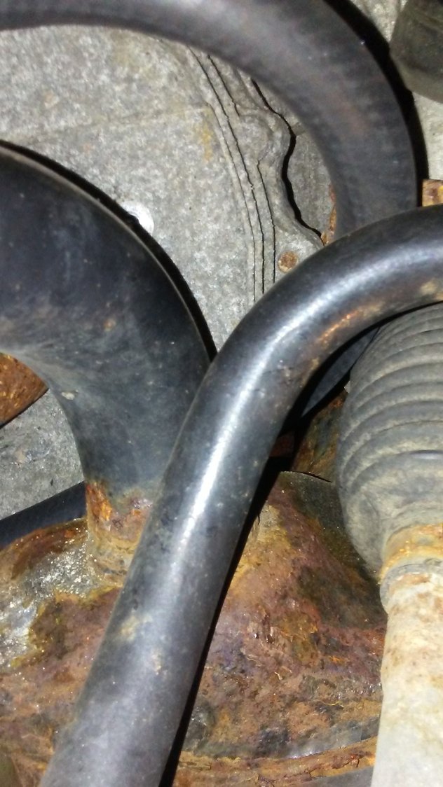

The original steel tube has a short piece of hose on either end, which connect to nipples. Just that the steel tube and both short pieces of hose off and run one long piece of hose from nipple to nipple. If you're worried about road debry you could run the hose through a piece of steel electric conduit just for protection. So much stuff rusts on these things I think I'll be getting rid of mine asap. Here are some pics of my solution:
That looks like a good workaround. The part only seems to be available from the dealers at this point. If I had the tools to do it myself, the OEM part and my labor would be an $80 job. With their labor it's a $240 job. Mitsubishi actually recalled the Galant because the steel ATF cooler tube, which performs a very similar function to this part, was rusting and leaking. The problem obviously is more widespread than just on the Galant, but maybe the coolant tube itself isn't recall-worthy to them.
