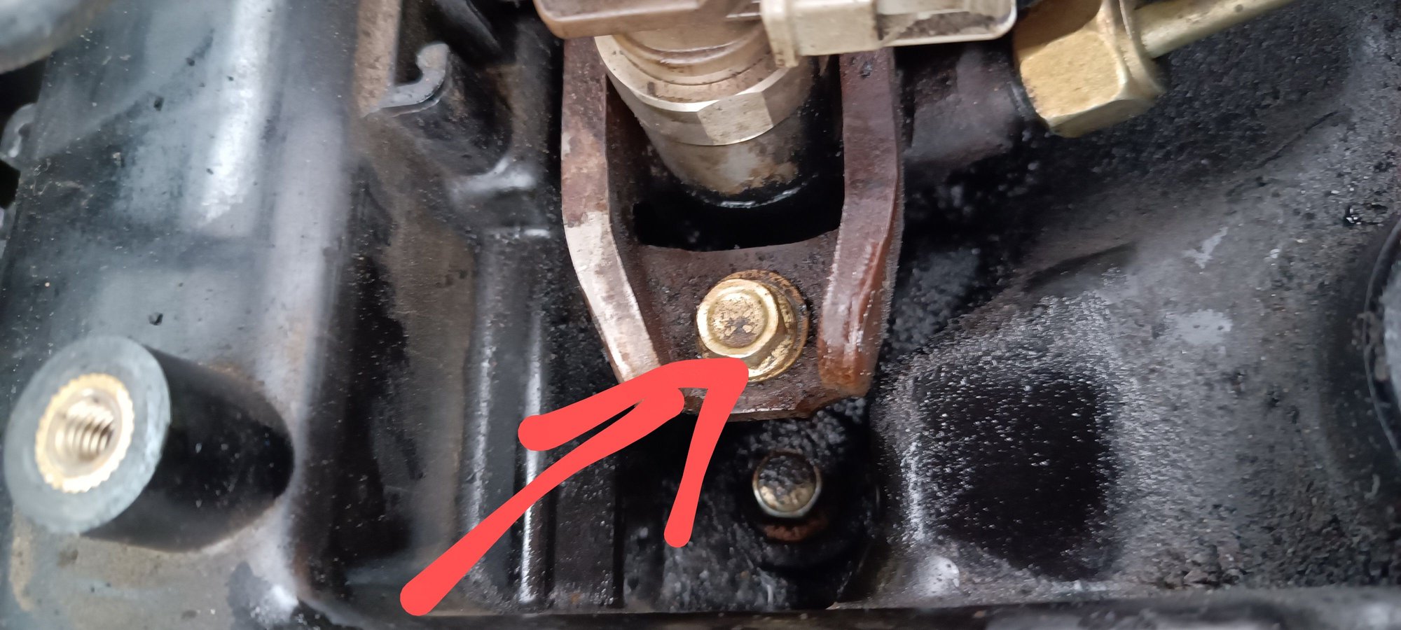

After that I was checking under the bonnet and could hear what sounded like air escaping from the Oil filler cap.
This had me confused because it made no difference if I removed the cap, same sound, but if I put my hand over it the sound stopped.
Confused I instinctively decided to take the engine cover off. I immediately realised the noise was coming from number 1 injector...WTF I thought.
I put my hand on the part in the picture (injector carrier?) and pushed down and could feel either the injector pulsing or the piston pumping.
As I pushed down I could see the carrier moving up and down.
I then realised the bolt was loose, so tightened it up.
The noise immediately stopped.
Now further to this for the last couple of weeks I've had running issues.
Bad idle, stuttering on acceleration and what felt like a bad driveshaft causing vibration when crusing under 2.5k.
After tightening the injector these symptoms seem to have all but cleared.
​However what I don't understand is why when it was idling rough did it instantly smooth out when disconnecting either the MAF or EGR?
Anyway my question is what should the injector bolt be tightened too? I don't want to cause issues by over tightening it.
Secondly what are people's opinions on whether this was contributing to the DPF issues?
Obviously it would have been pulling in extra air messing the fuelling up in that cylinder.
