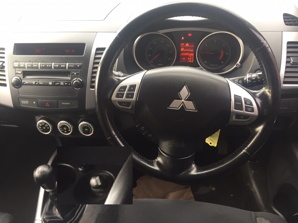

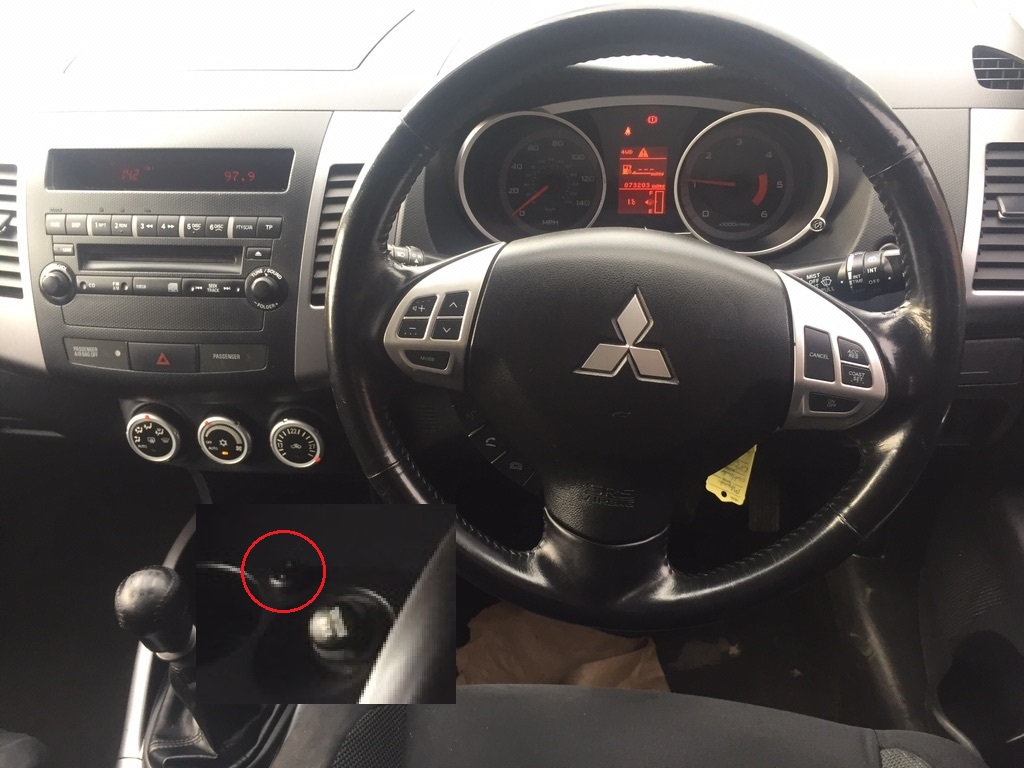

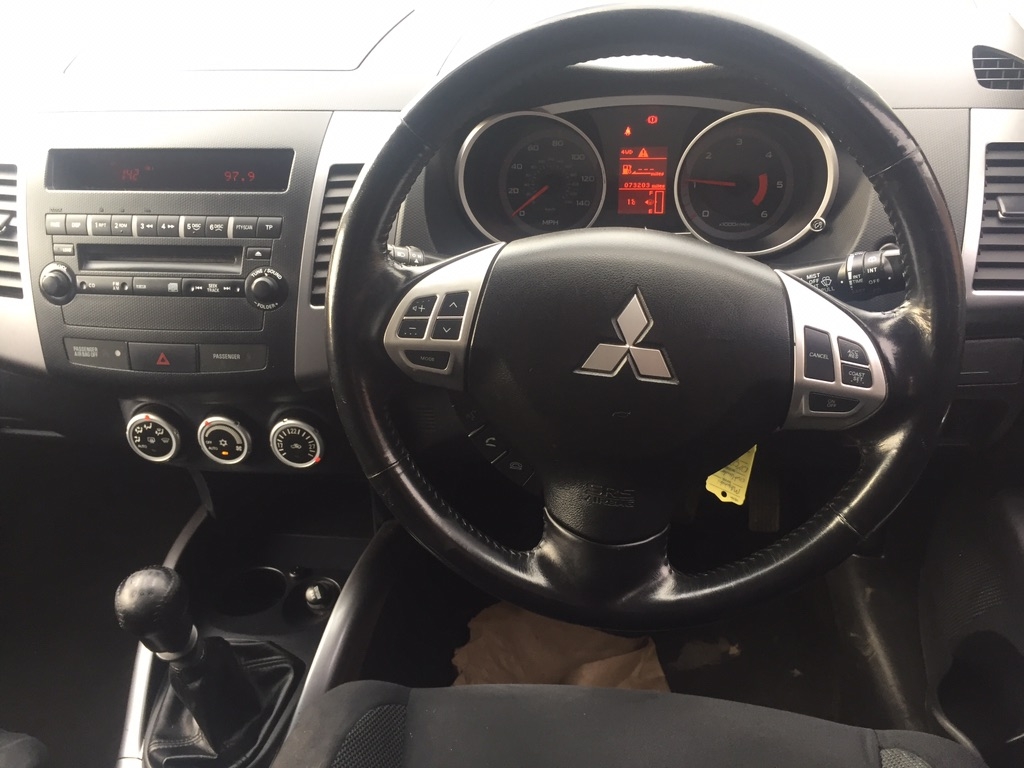

Is your Outlander inside the same as the image below?
Attached Thumbnails New oener needing advice. Please help-12166383-1-.jpg   New oener needing advice. Please help-12166383.jpg   New oener needing advice. Please help-12166383-3-.jpg
Hi, yes it is the same button as highlighted.
when I push it is cannot see any reaction except the little red LED on the button briefly lights up.
