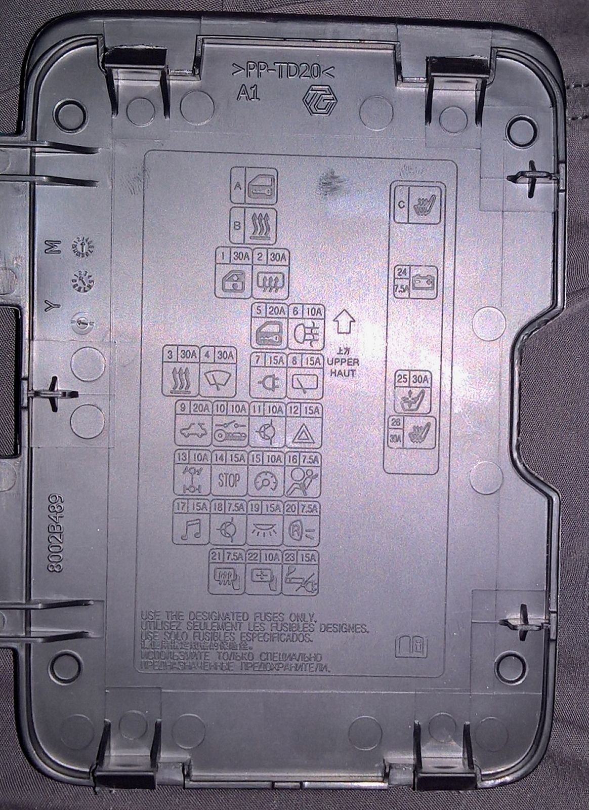

The only one easy and logical (to me) way of disabling alarm would be to pull off the fuse. For my Outlander it is No. 20, 7.5A one in the fuse box under the dashboard. Check other fuses in the box under the hood.
