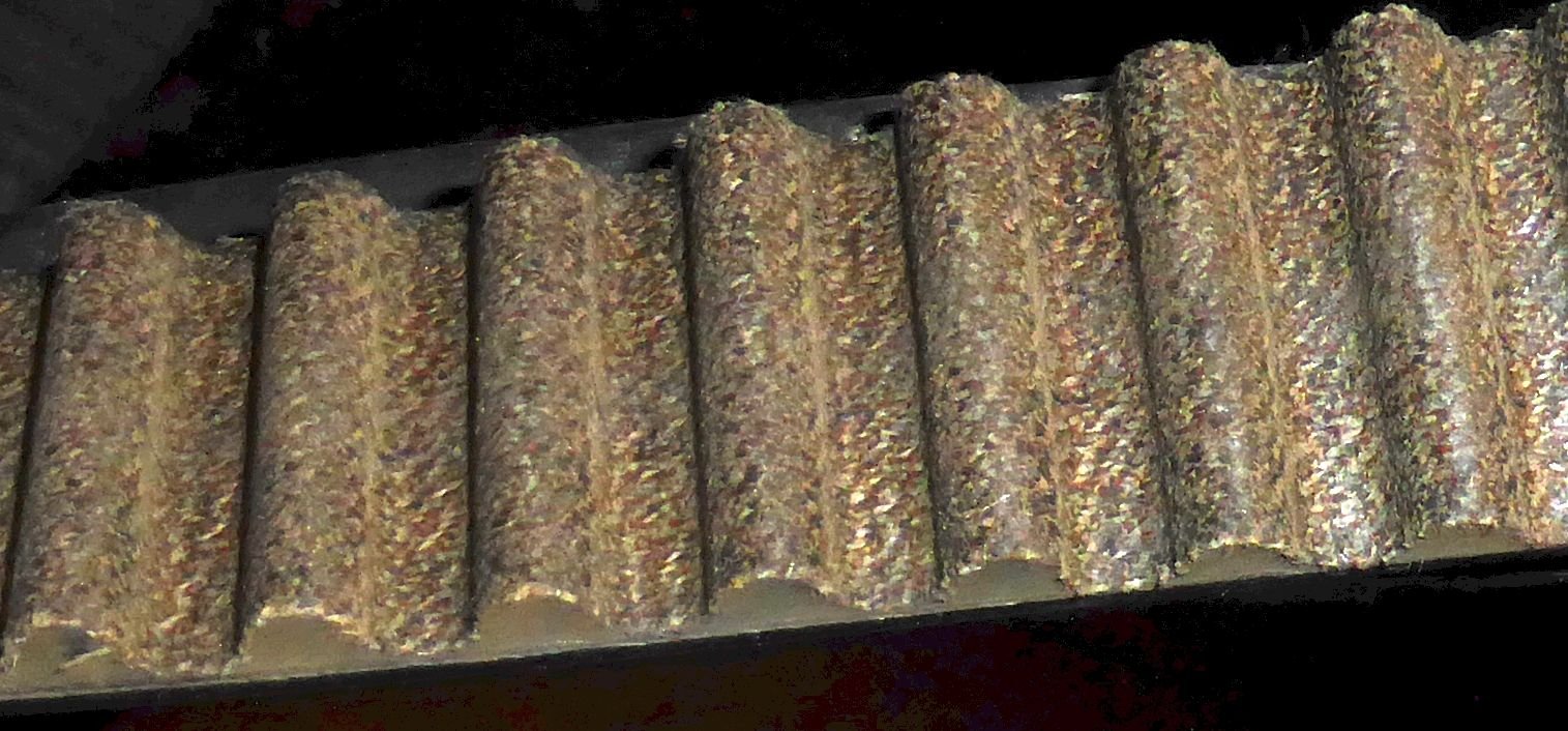

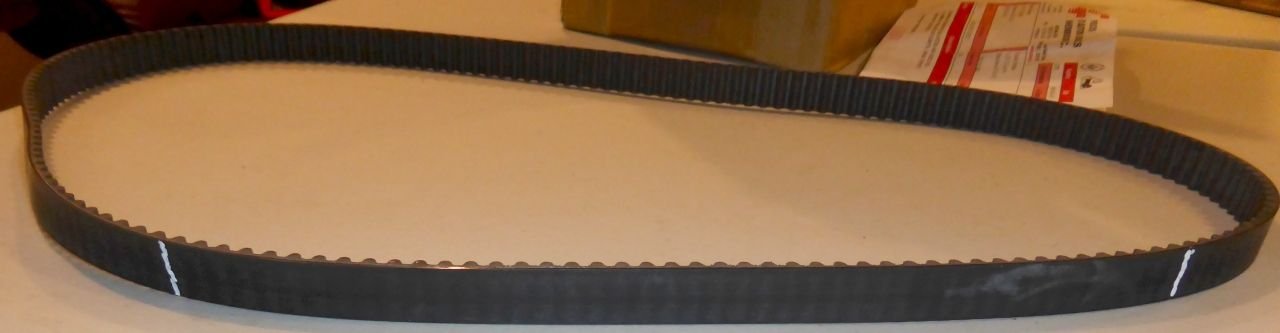

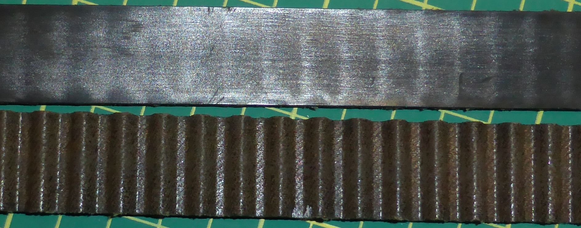

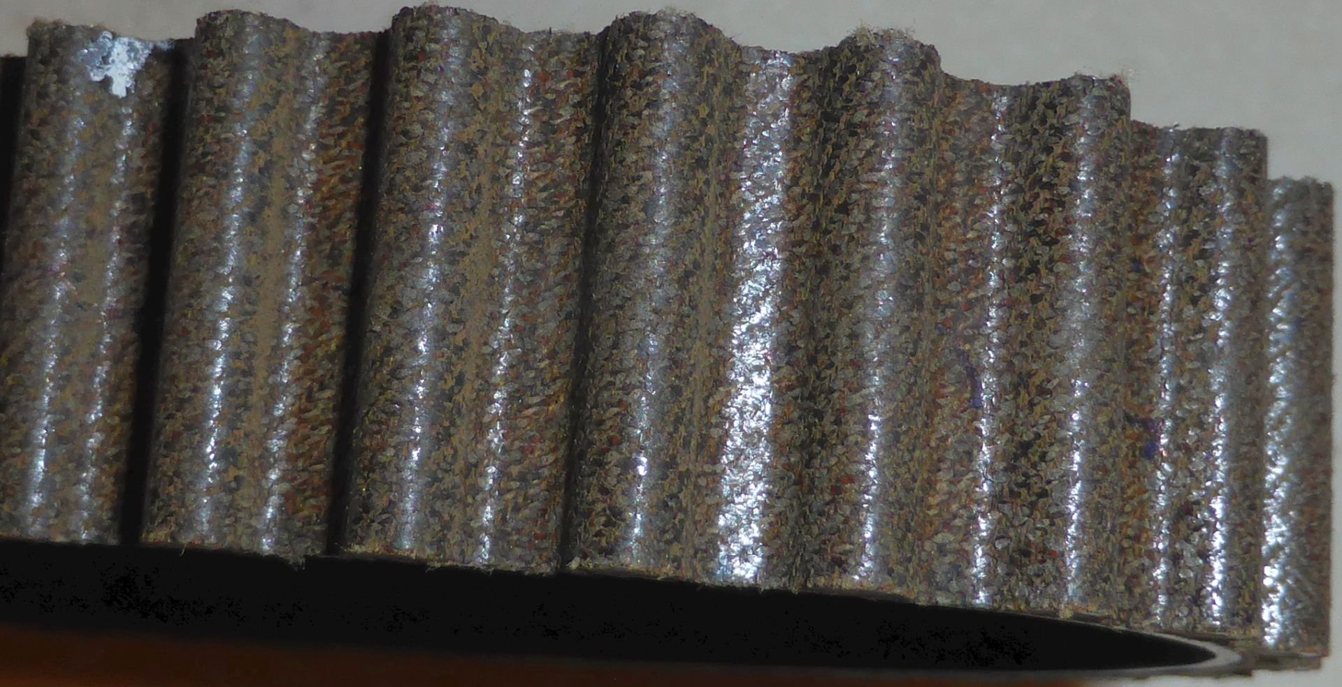

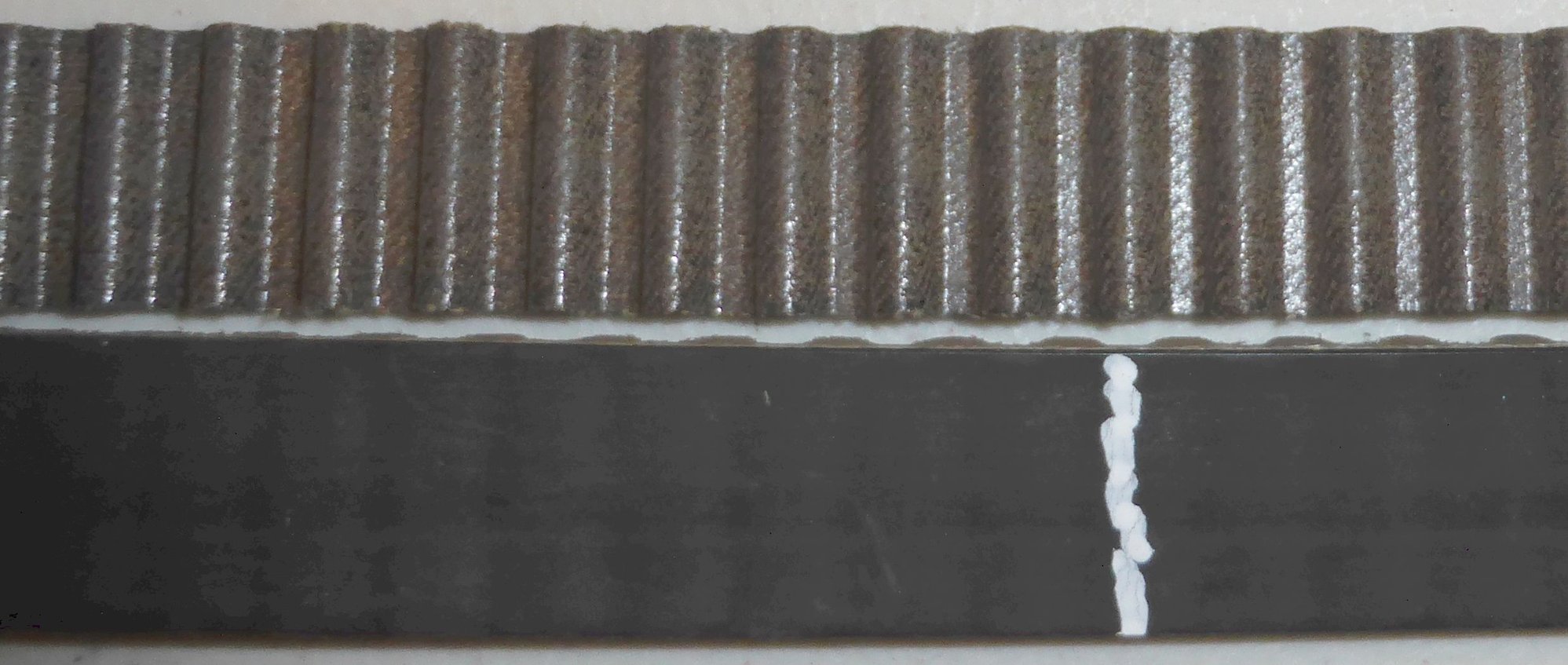

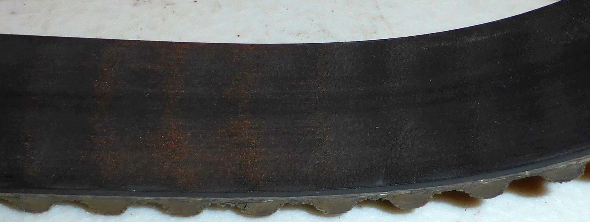

Luckily for you, I saved all the old parts from my timing belt job (plus water pump, gasket, tensioner, idler pulley, cam seals and crank seal, along with new accessory belt and other belt). (I saved these because, along with receipts and photos I took while doing the job, I wanted to be able to prove to the next owner, beyond any reasonable doubt, that all of these parts were in fact replaced when I said they were replaced. This will be a good selling point, I believe.)
The condition of the old belt is good. In fact, I can not see absolutely any wear on the belt -- no cracks anywhere. Considering the conditions that these belts endure, they are absolutely amazing, but they and their associated parts are a nightmare to replace (for inexperienced me, anyway).
(If I had it all to do over again, in 2013 -- when we bought our Outlander XLS -- we should have instead bought an "old technology", body-on-frame, easy-to-fix, uncomplicated, reliable, 4.6L-V8 2011 or earlier Mercury Grand Marquis, Lincoln Town Car, or Ford Crown Victoria which are all essentially the same Ford vehicle. The fuel economy of these big, comfortable tanks is only slightly worse than that of our V6 Outlander.)
Anyway, here are some photos of representative areas of the original OEM belt that I just took after reading your post.

Thanks for the photos mate. Yeah it looks like brand new, I guess it was build to last. Very nice that you were able to change it on your own.
