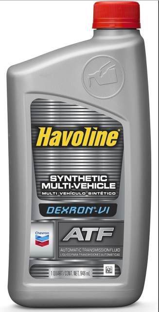

Here's the fluid I put in our transaxle:
Amazon Amazon
You will see that at Amazon, it's out of stock, but you CAN and SHOULD read the reviews.
Here's a photo (notice it's full synthetic and DEXRON VI):
As I mentioned in my 2019! (time flies) post after fluid change, the torque converter may not have drained. Regardless, our transaxle has never had a hiccup since I changed the fluid. If you're worried about mixing different brands, just mortgage your house and buy some J3.
This discussion has reminded me to pick up some more Havoline. I've just gotten a quote for $8CAD per litre from a local supplier.

Thanks for the advice. I am a bit scared to do the whole procedure. What I can do is only to drain the oil from the pan and do this more frequently. Just have to find the right fluid that is not expensive. I don't thing Havoline is widely distributed in Europe.

Is the fluid still cherry pink? If yes maybe still good to go with it.
Don't Havoline produce some new type of synthetic atf fluid? Here the Havoline Multi ATF costs around 10USD per liter.
