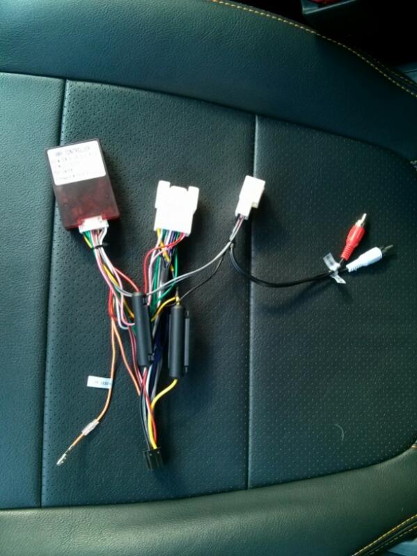

Hey All,
I have purchased a half decent after market stereo and have everything working except for the rear camera.
I don't want to (and shouldn't need to) replace the rear camera with the cheaper looking one that came with the stereo and completely re-wire it.
Does anyone have any expierence with this, i have attached an image of a strange looking box which is left with 2 wires, now i think i might need to connect one to a live and one to the reverse wire connected to the canbus decoder but i am not sure.
Thanks
Steve

I couldn't resist in checking the new radio...
After having removed the OEM I plugged in the new device. Plug, but no play...
The radio powers up and is booting the (Android) system, but that´s all. Allthough IMO properly connected to the OEM harnesses there's one gray connector left with no receptacle on the device or the new harness. This is apparently the same one you connected this "strange looking box" to.
My radio did not come with such a box.
BTW, the OEM mounting brackets do not fit to the new radio case.
Think, I have to contact the seller, too.
As we do have the identical problem, it would be helpfull to share pictures and experiences here.

Ah, thats not good, nah i got a WinCE stereo, brackets fit, the lot, latest from seller is the camera should also have worked pnp.
The grey plug top right connects to what your holding, the other two white plugs fit the factory plugs.
Goodluck, will let you know if i resolve it.

The harness I have is similar to yours but does not have the blue connector. The canbus box sticker says "Amp Controller - for Lancer" and apparently the box does not switch on the Rockford Fosgate amplifier under the passenger seat.

No passcode needed after reconnecting the device. With P/N I can not help, mine is a L/H driver.
BTT: Can't get the rear camera and steering wheel controls work, same for the Rockford Fosgate amplifier.
Reason: Seller send wrong canbus box. They will send correct one, then we'll see...
