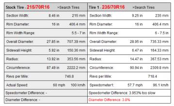

I'm also interested in finding out about that size tire too. would it work if the OEM are 215/70/16? Would it mess up ABS or warranty?

Have a look at the difference.
To compare size use this.

Attached Thumbnails P235/70R16 Tires-capture.jpg

i am riding on 235/70r16 Yokohama I/T GO72 winter tires witout any clearance issues.
actually, still plenty of clearance left that i think a 245/65r16 would fit. the added benefit of the 235 over the OEM 205: 1. smoother ride, and 2. spot-on speedo reading based on GPS.
