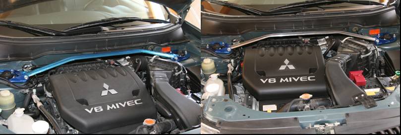

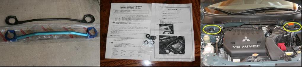

Hi, I replace the OEM strut bar by CUSCO strut bar, my source, japanparts. Easy to install and great look obtained. Here some pics
OEM strut bar vs CUSCO strut bar / install's documents and washers (6) / OEM strut bar removed

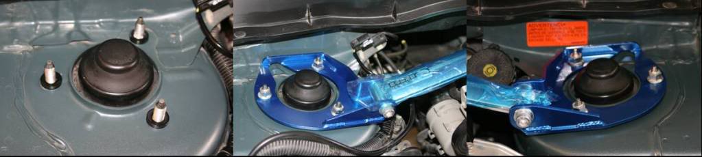

Washers installed / strut bar ends held in position. Nuts torque set to 33 ft-lb. Next, tighten the screw the horizontal bar
I removed the cover plastic blue... and work finished
