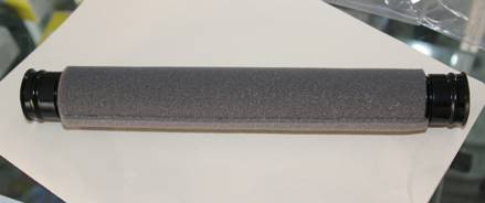

1. Remove the MMCS unit (https://mitsubishiforum.com/m_124086/tm.htm). Here the OEM hose (PN 7830A084):

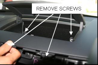

2. Remove cover over MMCS unit. After remove the screws, gently pull out upward, is assured by clips

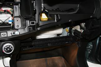

3. Remove lower glove box

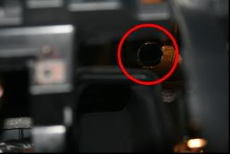

4. Here the cover that covers the port to insert the end of the hose. It is necessary to cut it with a knife. Be carefull because is a plastic very strong

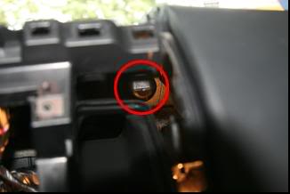

5. Port once cut the cover in air duct
