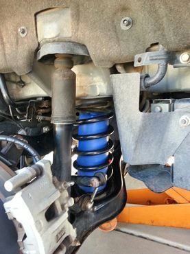

So the rear shocks on my '11 Outlander have finally given out making the back end a little unstable. I bought a set of KYB's from Rock Auto and an going to attempt to install them this weekend. Tried searching threads for a quick how-to guide. Can't remember if the interior plastics need to be removed or not. Can anyone give some quick advice other than taking it to the shop? Should be pretty straightforward, right?

Nevermind....this job turned out to be way easier than I thought. Only struggled a little with the top bolts of the shock housings. Not much room to work with in there.

The back end was getting little bouncy from what I remember and handling around corners was a little sketchy. I have these airbags installed so it wasn't bottoming out. But the shocks were leaking real bad. The overall ride was very much improved after doing the shocks. Now considering doing the front struts too.
