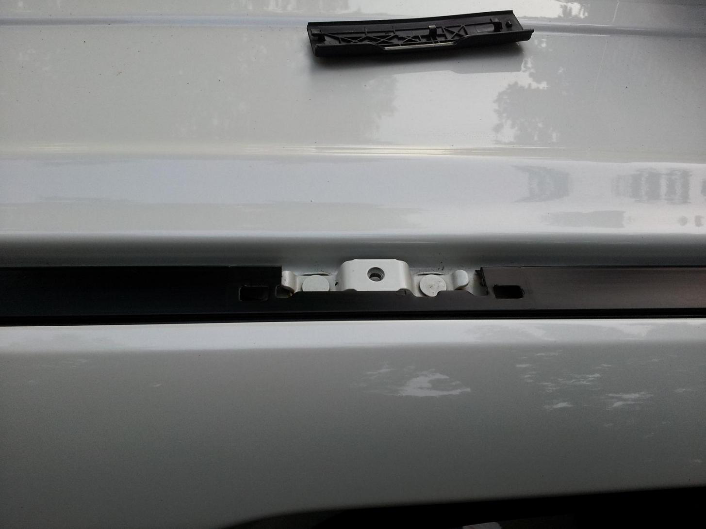

I searched for nearly a year looking for a solution to put a roof rack on my 2013 GT. Yes, Mitsubishi does offer one:
http://www.mitsupartsworld.com/mitsu...cessories.html
The problem with this is I really dislike the square bars that this and the standard Thule racks use. Im also not a fan of the round Yakima bars.
So both Yakima and Thule make streamlined aluminum rack bars. Go through their fit programs and they will spit out some parts for you to get. Order these parts and you will be sorely disappointed to see that it fits in the door jam not on the points that Mitsubishi so kindly gave us.
While stumbling through some documentation I found the manual for a Thule fit kit #3093 that states it will work on a 2010+ Outlander Sport. I figured why not try it.
It came in and mounted right up. I would take this to say that any rack that fits to fixed points on a Sport will also fit on an XLS or GT. Figured I would pass this knowledge along.
Anyway, to my particular parts and install. As I said I wanted the profiled bar so I spent a little more than most would. Breaks down as follows.
Installation kit: 3093, $75.95
Towers: 460R, $170.95
53" Aerobars: ARB53, $134.95
Total with tax and free shipping: $408.59
Again, you can get cheaper if you go with square bars.
Install was straight forward. The only tools I needed that werent included was a flat head screw driver to install the lock blanks.

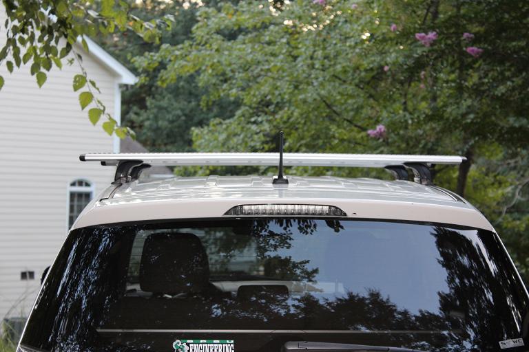

I did spend a little bit of time centering the bars so I figured I would post my measurements for future reference. See attached picture for where I measured.
Rear: 5.625"
Front: 5"
I think it turned out nicely, though I would like my bars black. I may pick up a can of Plasti-dip and see how they turn out.
Just a note: I do not think the next shorter size bars(47") would look good. You would have roughly 2" overhang on each side at the front which I think is too little. Try it if you want though. Use amazon and get free return shipping.

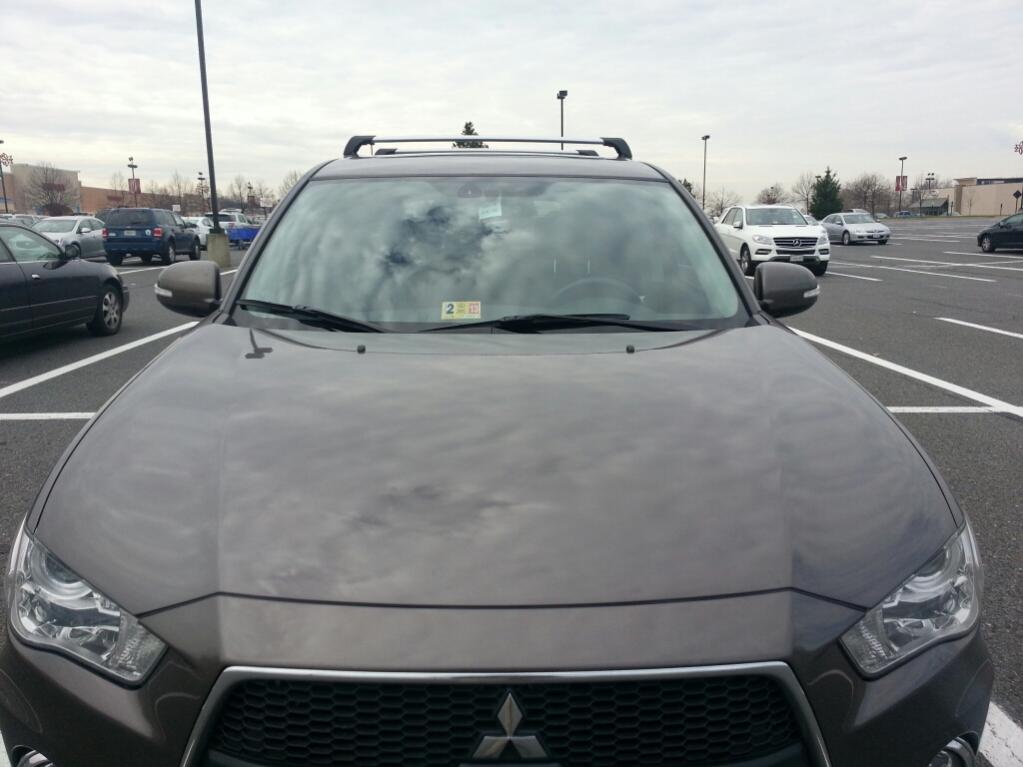

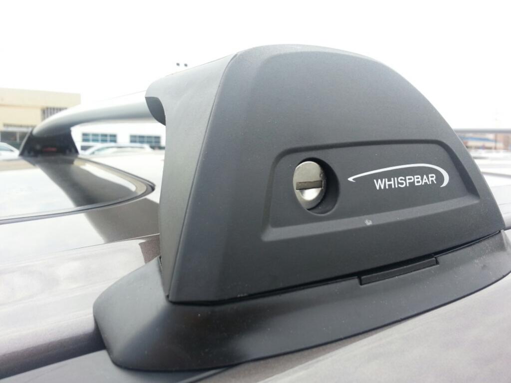

Don't know what you mean, my Yakima fit just fine. I got the Whispbar Flush System with the S25 Flush and Whisbar K509 Fit Kit.
Attached Thumbnails Roof Racks for Outlanders without Sidebars (GT, XLS)-1379436488845.jpg   Roof Racks for Outlanders without Sidebars (GT, XLS)-1379436663001.jpg   Roof Racks for Outlanders without Sidebars (GT, XLS)-1379436716619.jpg   Roof Racks for Outlanders without Sidebars (GT, XLS)-1379436762775.jpg   Roof Racks for Outlanders without Sidebars (GT, XLS)-image-1.jpg
Old Sep 17, 2013 | 01:11 PM
OutlanderGT's Avatar
Joined: Jun 2012
Posts: 381
That looks really good with the Yakima.. I assume they have bolts that goes into the factory points even though they are meant for Thule?
Old Sep 17, 2013 | 01:17 PM
Phatty McPatty's Avatar
Joined: Jul 2011
Posts: 73
From: Washington, DC
Yeah I believe it's a universal anchor point.
