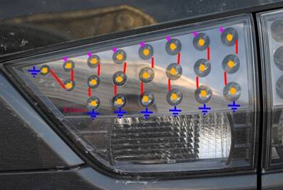

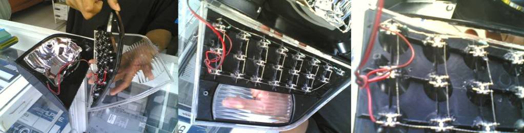

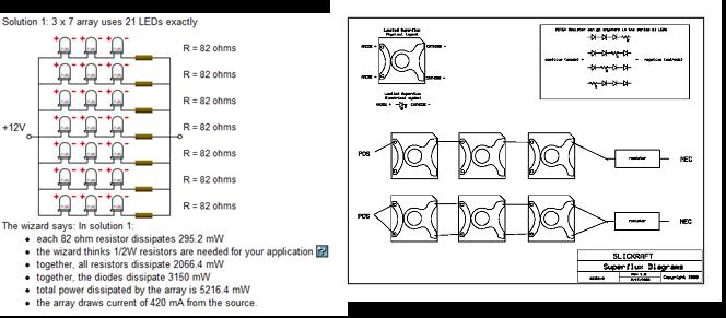

I did this project with the help of my friend Richard and I acquired the documentation in HIDforum; in that forum contacted a person and he sold me the LEDs, the motherboard, some components, and other components I got in my city. Here some pictures of the installation process and I'll share information about the control board kit. . .

I always had in mind for this project to work on additional lamps in case something broke. Finally my friend did not damage the lamps, as shown in the photo I attached, and he used just a knife to disassemble its (yes, that's what he said) . . .

Wow that is genuinely amazin.. I lost half my thumb nail on the oven heated 1 and made plastic fiber strand on the deemed one hehehe..... Was it a very clean disassemble or was it needing a clean up?
Old Jul 23, 2012 | 10:11 PM
  #99
jsrd's Avatar
Posts: 947
From: México
I really was impressed for his greast work, the only sign that he had opened the units, was a little ridge on one side (2 cm), finally he is car modifications people and has opened many units, so that experience was helpful in this project. . .
