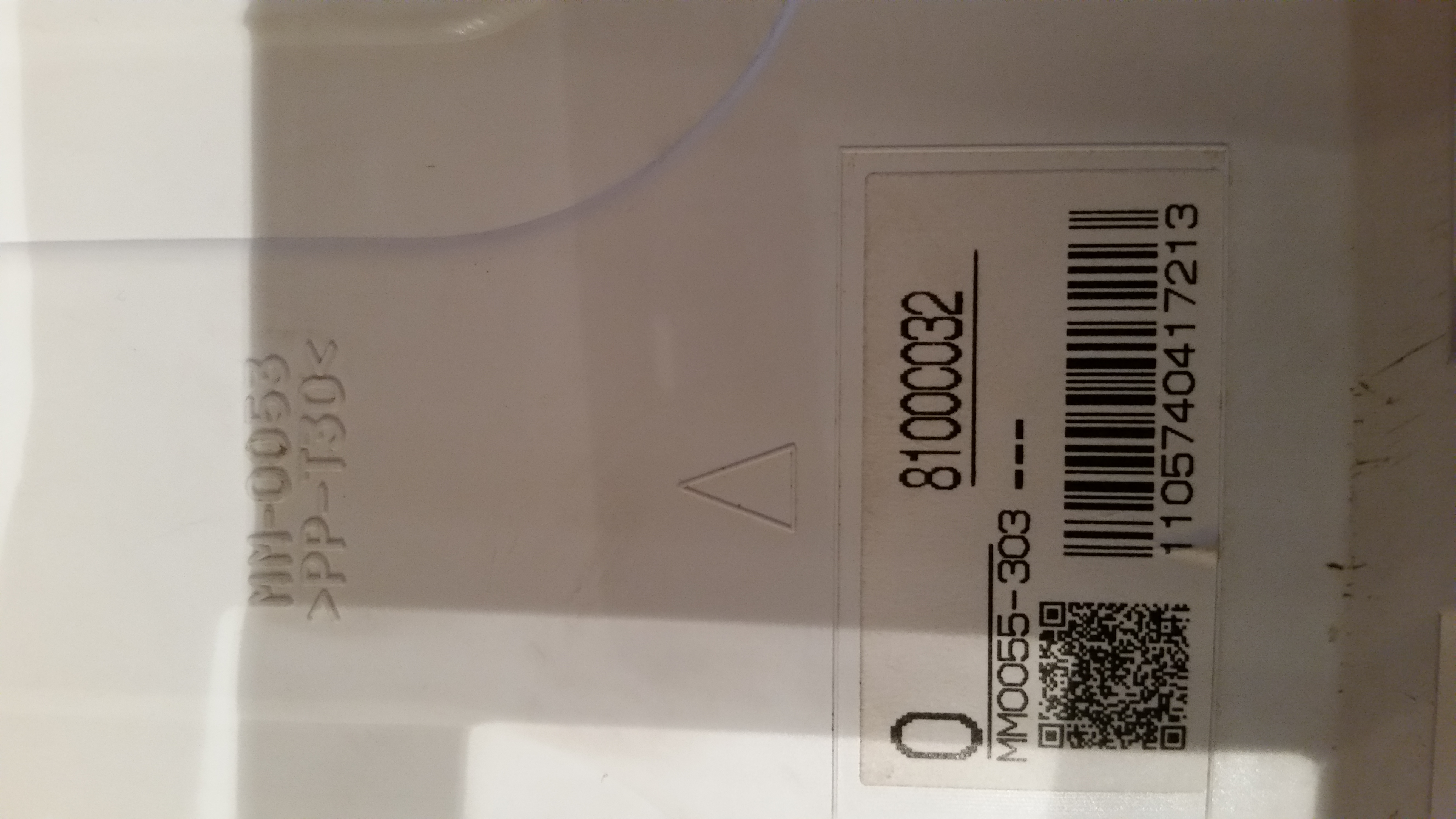

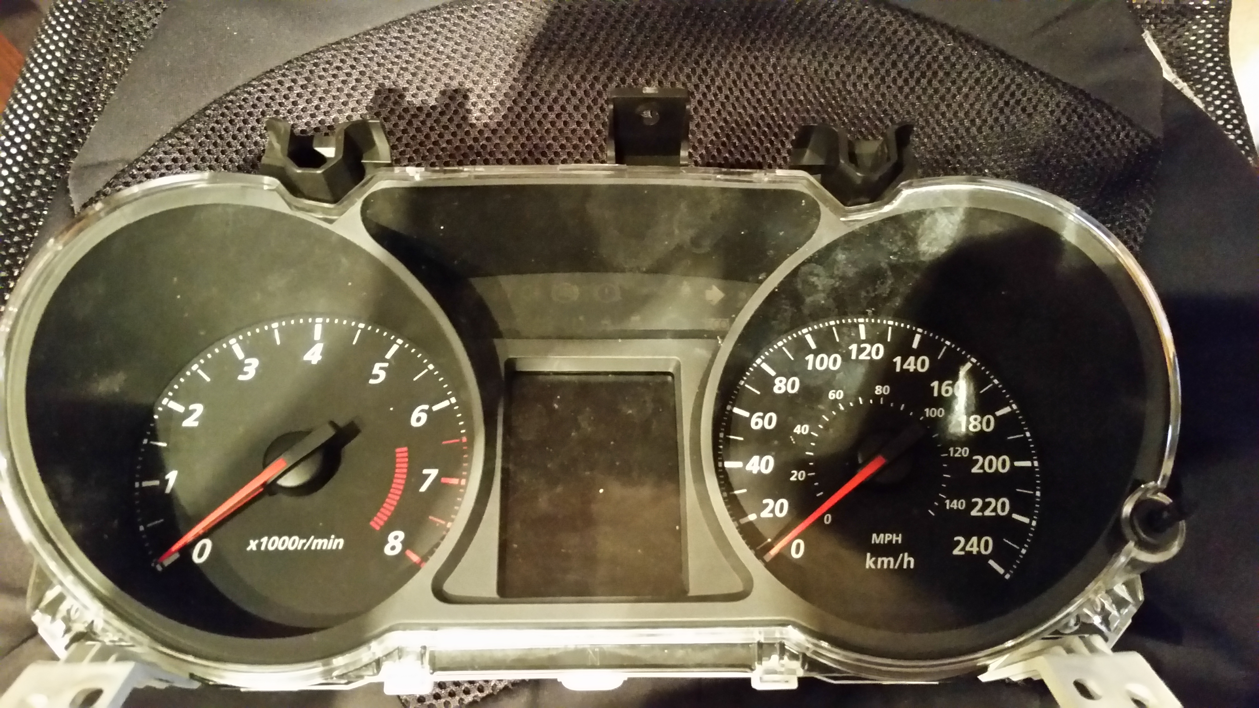

Just double checked what I've got and it is a color one. See images attached.

Yea, but that's from a european lancer. Maybe they went with monochrome red lcd due to a lower volume production run of gauges in KM/H??? Apparently, it doesn't follow the american outlander standard.

Here in Canada that's what we use - KM/H. How do you know it's from a Lancer? I was buying one from 2013 Outlander. Thanks!

When i look up the part numbers, all the links reference to a lancer. The gauge dials don't look like the ones from a color version. Perhaps they made one special for the smaller canadian market, but used a cheaper red one.
