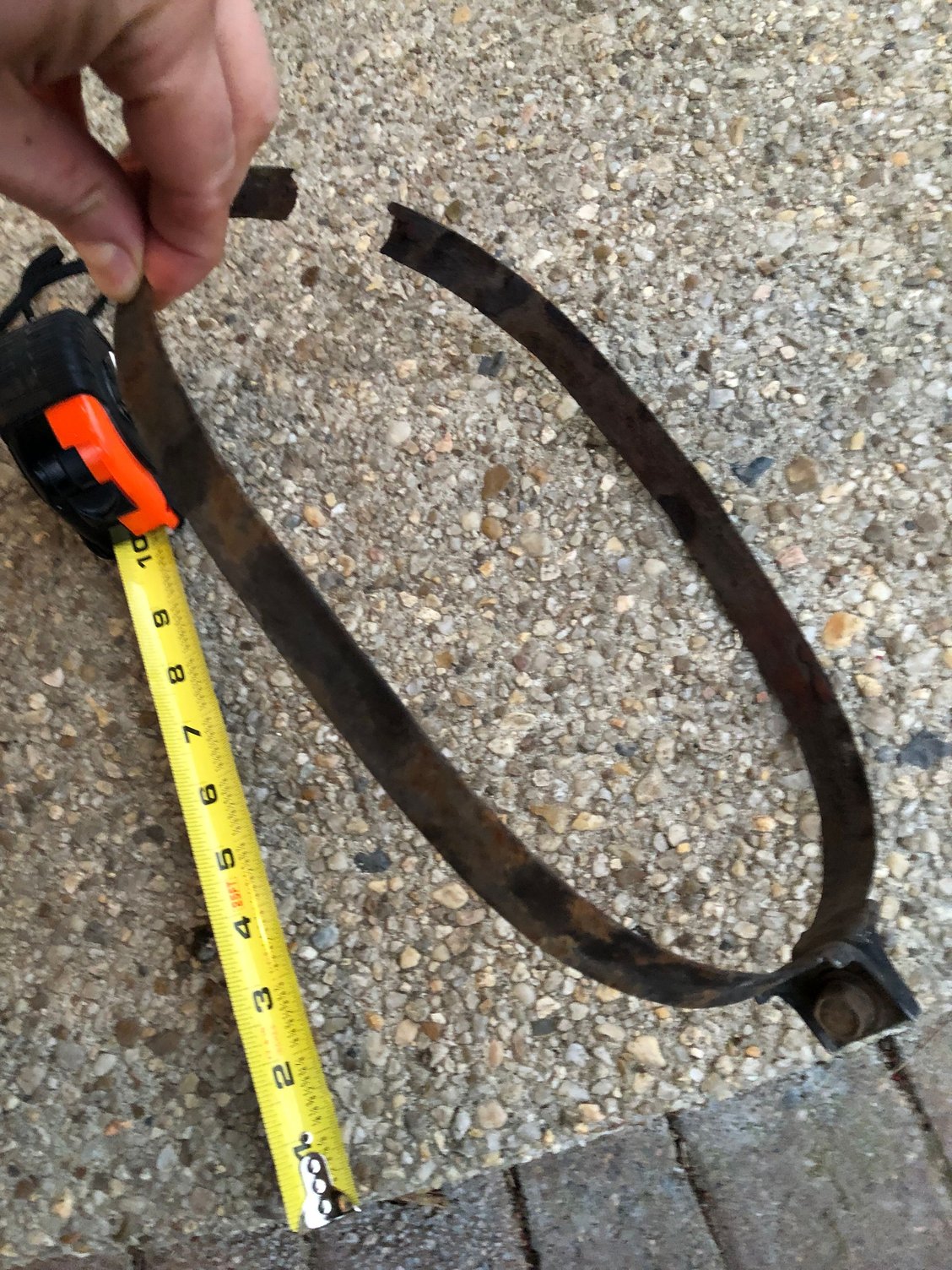

Here is the part I’m talking about.

Default Please check the attached page from the service manual
As you can see the service manual does not specify a band like the one you displayed. At some point someone must have installed it. You might want to check whether you have all the hangers present that are supposed to hold the exhaust system.

HI,
That clamp pictured was dangling from my wife's 2010 Outlander last week. Its purpose is to secure a heat shield directly above the muffler. It has no stability function of the muffler itself. I removed the dangling, rusted bracket in two seconds which also resolved her "clanging" problem.
