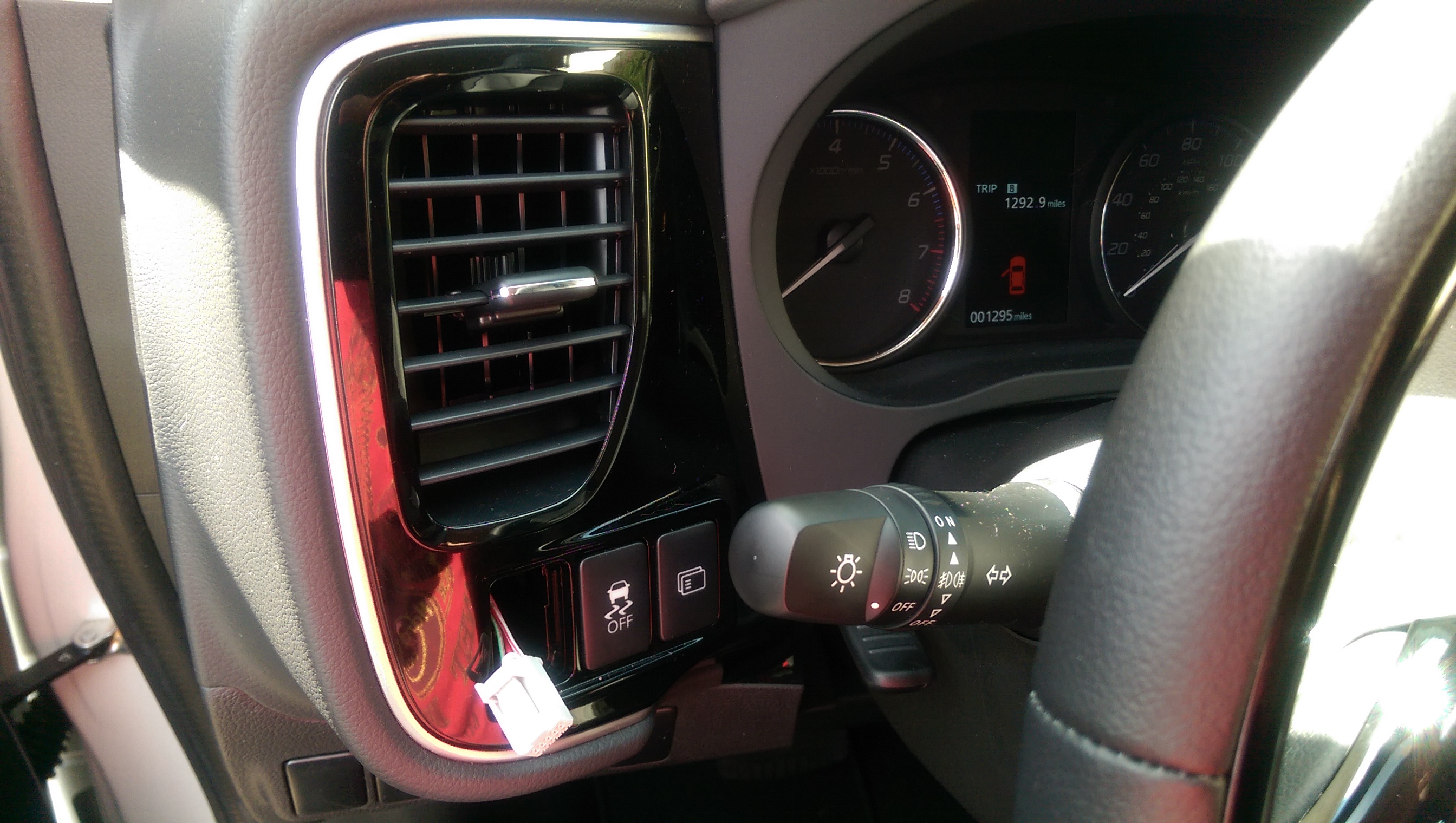

My 2016 Outlander SEL. I am going to install a switch to open my garage door. I have a blank in this spot, there is wiring there, can anyone tell me what switch the car is pre-wired for?

It's a headlight leveler on my 16 GT.

Thank You. Never heard of a headlight leveler, must have to do with the LED's. Now if I can locate a Pin Out for this switch so I can draw power when the parking lights are turned on.

Page 5-182 of the 2016 manual. All trims have the same manual so you should see it in yours as well. I would think all versions had this. If there is no in cabin leveler switch in yours, there should be a manual one under the hood. This doesn't answer your question, but maybe it'll help.

wow.... I've never seen anything like this before and I've been repairing my own vehicles for over 40 years, guess ya can teach an old dog new tricks. Thanx.

I'm trying to find a switch, a momentary switch to fit that hole. I can buy a liftgate switch from Mitsu and use that but the stealership wants $72 for it. I see a ton of switches for toyotas but they are 1/4" too big. Finding parts for this truck is going to be difficult at best it looks like.
