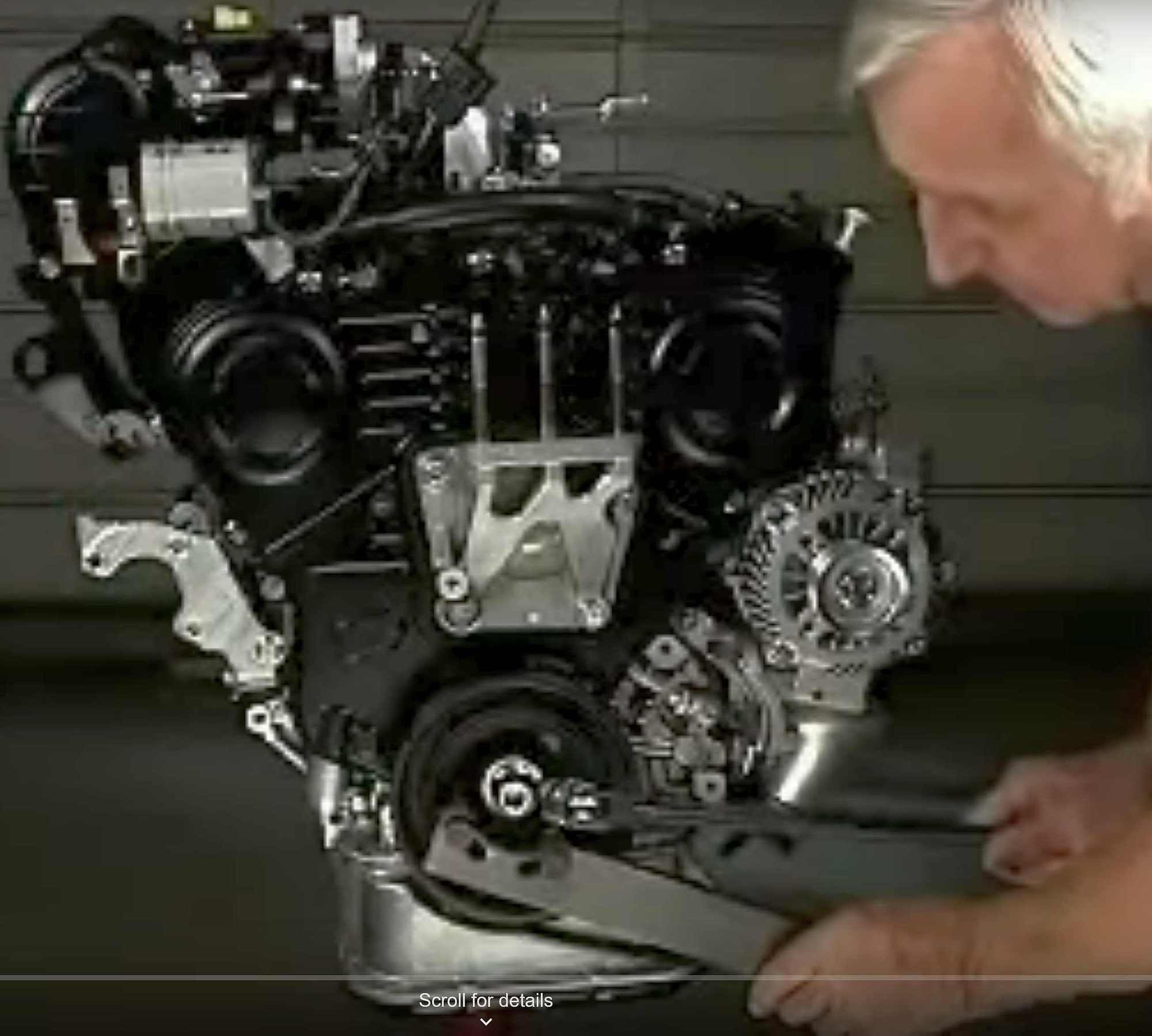

I think those with the pivot are not strong enough reviews are so not great.
The 2011 FSM does have a chart that list MB990767-01 (the OTC flat style) supercedes MB990767 (scissor style)
You really just need a piece of angle steel, drill two holes where you want to intersect the pulley, with two long enough bolt 3", 4 nuts. It would cost under $20. Cut out a bit to clear the pulley bolt if needed.
I would use the longer bolt highest grade you can find, where it doesn't have threads near the hex head, using the smooth area without threads to engage the pulley holes.

Sounds great. I'd be weighing the pros and cons of using thicker flat bar versus angle iron (which, let's face it, is going to lessen the space between the tool and the body of the vehicle and maybe inhibit to some extent the action of the impact gun or socket and breaker bar, etc.).
Please post photos of your new tool and do tell how it performs.

I just now noticed that the newer Mitsubishi OEM pulley holder is the one used in Mitsubishi's official 6B31 timing belt removal/installation video a number of years ago. So I guess that that tool is the one that Mit technicians now use to hold that pulley. Luckily it is nowhere near as expensive as the original tool, IF you can actually locate one. I'd like to know exactly why Mit. changed the design.

The tools are not made by Mitsubishi they are mostly made by OTC, Miller, and they don't only fit Mitsubishi.
The MB990767-01 tool should be a useful one around the garage, because it is also used to hold differential flange, hubs, etc. It should also hold cam gear to get that cam bolt off.

Sounds like you're on the right track, Outlaander. I just finished this job on my 2013 and ended up having to rent a Milwaukee impact wrench to get the crank bolt loose. I couldn't break it loose with a 4 foot pry bar (I bent the heck out of my homemade pulley holder), but the impact wrench broke it free in about 3 seconds. This was the most annoying part of the job for me, but only because I don't have a powerful impact wrench at home. You'll definitely need a pulley holder of some kind and probably a long breaker bar/pipe to torque the crank bolt when re-installing. I see you're in Alberta - if you're in Calgary you're welcome to borrow my homemade version. It's not a bit bent, but still works.
