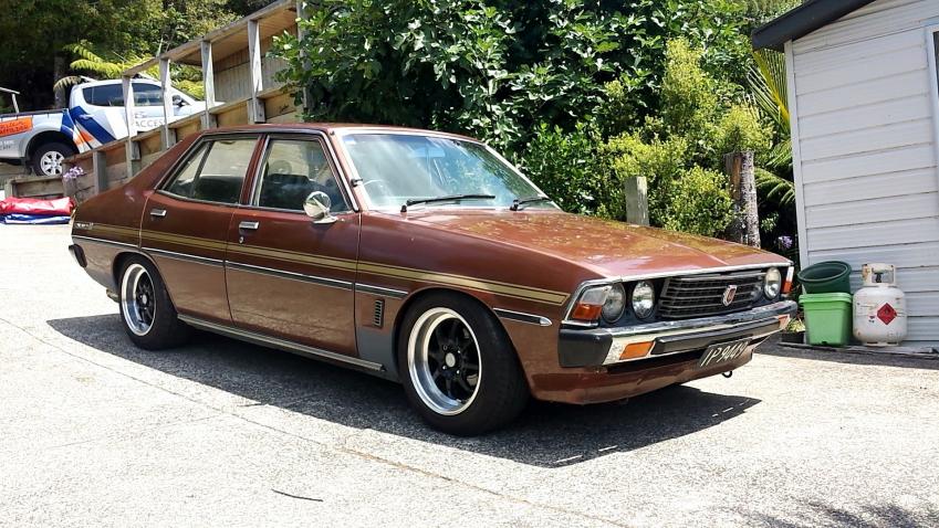

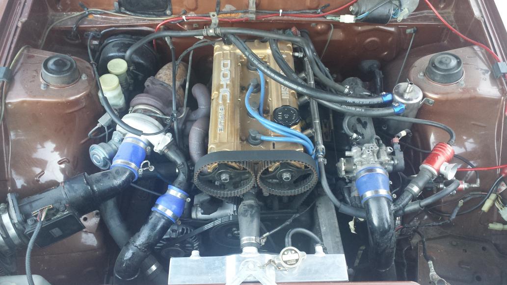

I havnt got many photos at this stage, this is the car how i got it. Engine has been set up in a way that i don't like, (intercooler piping) etc etc. Has a lot of work to do to get it to a good standard.
Thanks heaps for your help, i havnt got many people to get advice from, so appreciate yours. You obviously know what your doing.
