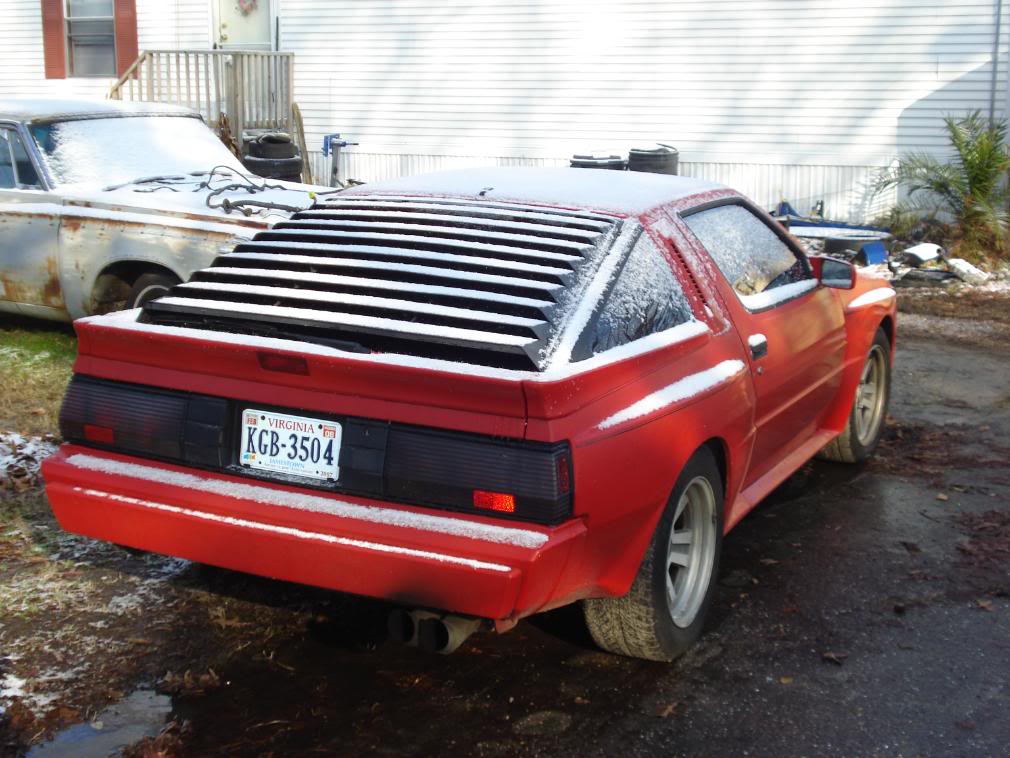

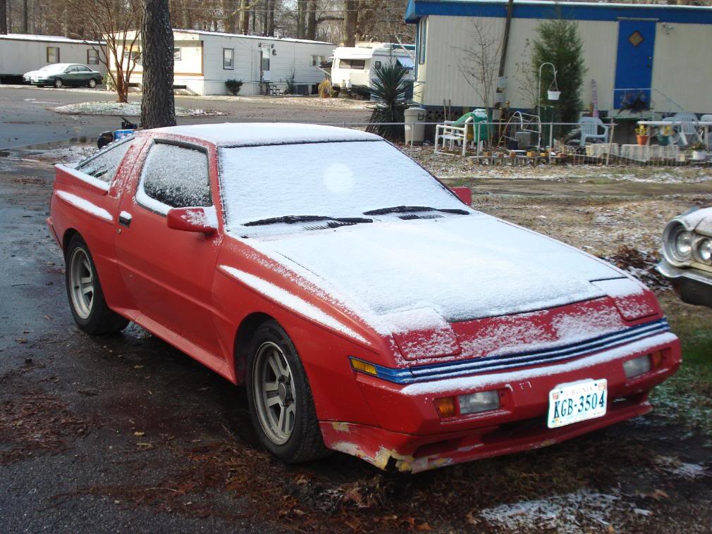

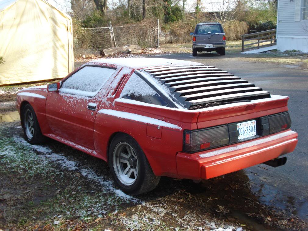

Well here's the new pics of her. Took them after the snow and my installation of the rear louvres. Still trying to find a metal set for the sides to match the rear but if I don't then I will be putting the plastic ones on until I located them.

wow looks good man other than that front bumper lol

lookin great man.
