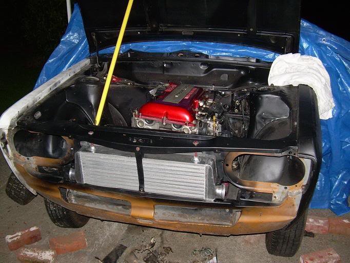

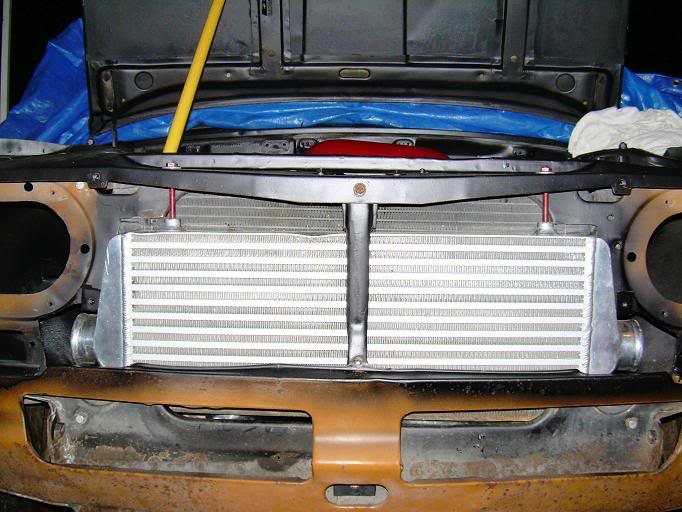

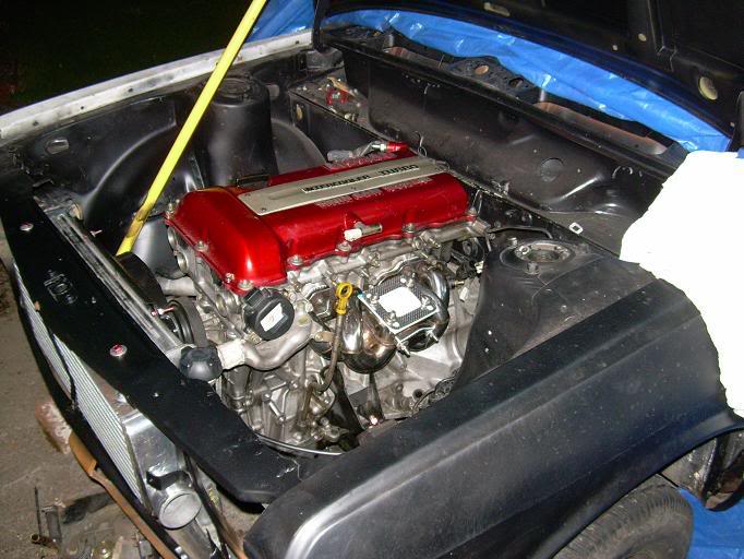

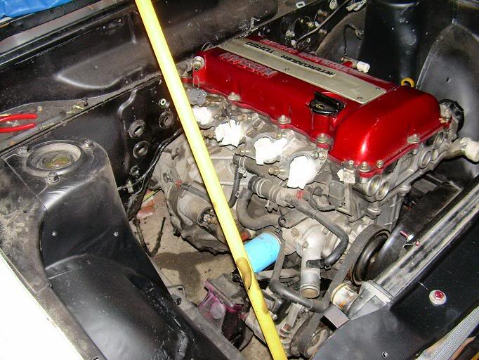

Finally, i have some pics up for you. These were taken a couple days ago and a few more things have been put on and are filling up that empty space! But i havent had much time to work on it with graduating soon and making sure my grades stay up. I spent a lot of time removing rust on the interior, and the engine bay had to be really cleaned up, sanded and paintedbefore putting the motor in, so its taking longer than expected.
But basically i got the engine in on its mounts (tranny mount is being modded right now), intercooler fitted, radiator hooked up, and i found a nice electric fan sitting in my auto tech, so i snagged thatand its on there too.

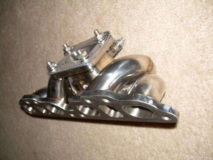

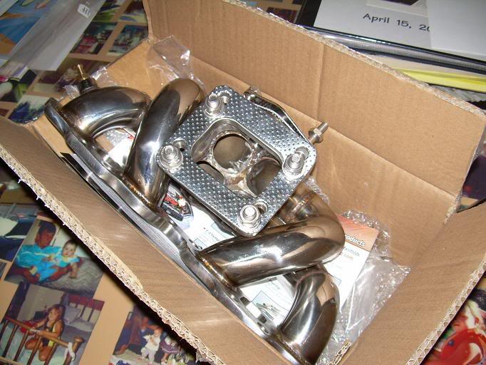

I got my top mount exhaust manifold today, but its a t3/t4 flange instead of a t25, so im just going to upgrade to a T04E, and an external 38 MM gate next week.

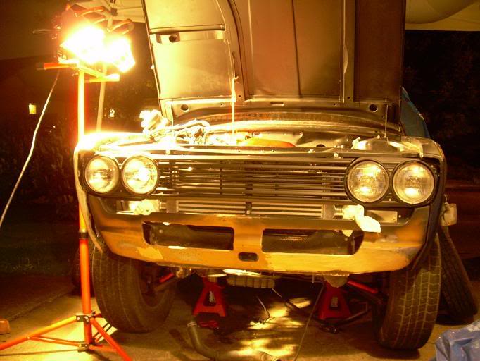

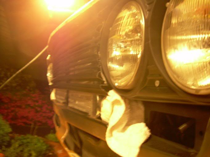

So i guess its time for an update:
SInce the last update i have reversed the center steering link, modified and bolted up the tranny mount, modified the coolant hard lines, have gotten about 1/3 of the wiring done, hooked up an electric fan,did some body work on the front end, painted and put on the grille, put the headlights back on, hooked up the clutch master and slave cylinders, put the brake master cylinder back on after being cleaned,Measured and dropped off the driveshaft to be shortened(should be done wednesday or thursday), ordered the T04E turbo, and 38 MM 15 PSI wastegate, and probably a couple other things im just not thinkin of.
Oh yeah and i found another good part i need in my auto tech class. Its just the upper radiator hose, but free is a better price than 10 bucks.
I only have a couple pics
