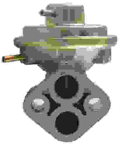

also like i was asking before one of the plates bolt's to the block directly right?

It bolts to the intake manifold. The reason im getting rid of it is cuz im doing a 6 bolt swap and dont want to deal with the map sensor. If you are really THAT worried about combustion temps then get alky/water injection or just a better FMIC and you could even spray it with co2.

Yes Bud66, the plate covers the hole on the side of the head that is left after you remove the EGR valve. There are usually two types of plates you can get too. One replaces the EGR valve and the other is used as a gasket but it's solid all the way through (except the bolt holes of course) and you retain the valve and you can also keep the EGR system intact.
