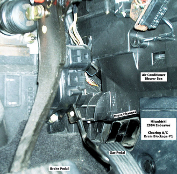

I had the same problem until today - here is the solution --
-- open the driver's door
-- locate where the air conditioner blower box is attached to the passenger side of the firewall – look to the immediate right at the top of the gas pedal arm
-- condensation flows toward the front of the vehicle through the firewall at the leftmost edge of the air conditioner blower box - see photo #1

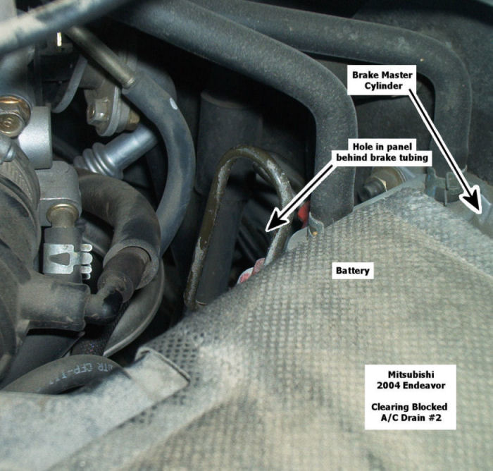

-- open the hood and stand next to the front wheel on the driver's side
-- look down at the firewall over the battery and to the passenger side of the brake master cylinder
-- locate the small diameter metal tubes running horizontally and attached to the engine compartment firewall
-- locate the hole in the engine compartment firewall panel behind the small diameter metal tubes - see photo #2
-- this hole leads to the drain opening in the air conditioner blower box mounted in the passenger compartment
-- follow the brake tubes as they run from under the vehicle and turn toward the front wheel on the driver's side
-- locate the hole in the engine compartment panel behind the brake tubes
-- insert a short length of stiff wire into the hole through the engine compartment panel to unblock the drain hole
