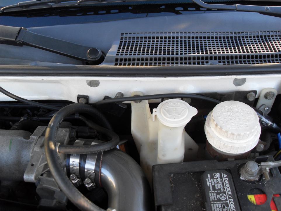

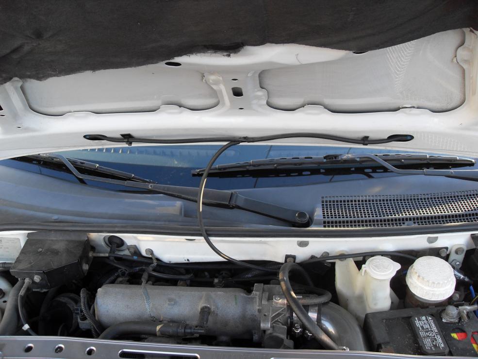

Could someone please post a picture of the the underneath of your hood to show the windshield washer hoses to show how they are routed on a 1999 Eclipse? I had to replace my hood and forgot how those hoses run as far as how they attach to the hood,

Thanks, I think I will go ahead and replace the thermostat since it is cheap and easy to do. I got the part where the lines come out of the sheet metal under the hood but it's the way they run from there to the pump and how they are secured in the clips that has thrown me off. A picture would be greatly appreciated.

I still need a picture of the windshield washer hoses and how they are connected to the hood. There are two or three clips that connect the hoses to the hood. I have them connected but it just doesn't see right. It seems like the hoses are too loose or have too much slack the way I have them connected. If someone could post a picture or two of the hood where the hoses are at I would very much appreciate it. Thanks!

For posterity's sake (and the OP, since he's still in need!):
Attached Thumbnails 2 simple questions.  Please help?-sdc17484.jpg   2 simple questions.  Please help?-sdc17485.jpg

Default Thanks man!
Just what I needed. Thanks a million!
