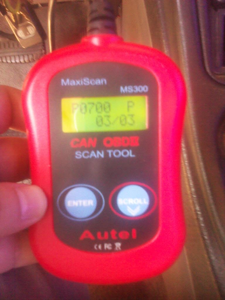

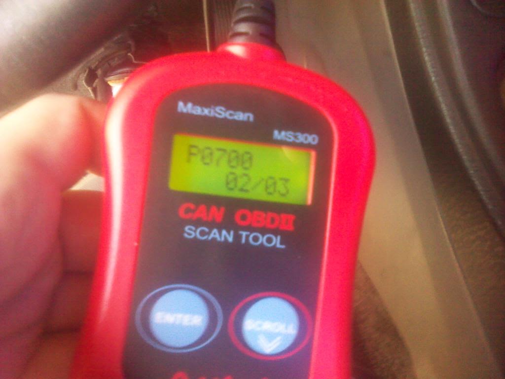

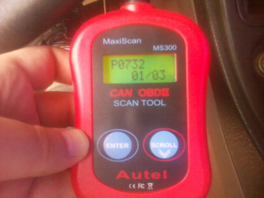

Anyways here are the CEL's codes:

Mitsu codes
P0700 Transmission Control System Malfunction
P0732 Gear 2 Incorrect ratio
I cannot help more than giving code interpretation.

Originally Posted by Claude_A
Mitsu codes
Thanks for the reply I appreciate it.
I looked up the codes as well and that's all I could get too. I've been reading online and some say it's the torque converter that's the problem and it's weak in our cars and most likely, never been changed since it was off the factory.
