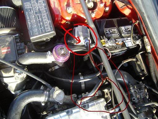

Ok i am have the symptom of a fuel cut. I can get through 1st gearall the way then in 2nd around 5k it kinda cuts of for a split second and then it will keepgoing up in rpmswith the cut off every second or so. And in 3rd 4th and 5th it does the same thing but it starts at about 3-4k. But if i hold the throttle about 1/4 of the way down it will go smooth through all the gears.I am pretty sure there is no fuel cut going on tho. I am running 15 psi on stock injectors and a walbro 190 fuel pump and i have an adujustable fpr. There are new NGK plugs gapped at .28 new wires new fuel filter. I am thinking it has to be a vaccume problem or something. My vac guage says about 16 and idle and goes to 20 if i rev to about 2k and let off gas then fall back to 15-16. Some times it is at 12 depending on my idle. The least owner of my car kinda F'd up my vac lines. I'm pretty sure the pvc vavle is not hooked up. look at this pic, The pvc line looks like it is going to the catch tank.

Yes it is connected to the catch can and that is fine. Thats what the catch can is for. To take deposits from the PVC valve and Breather hose. But it definetly sounds like you have a boost leak somewhere. Or a vaccuum hose that is loose. Do you get a CEL while its doing this

The CEL is on but its a O2 sen. There is no boost leak i had a bunch of work done to fix my boost leaks. And its still hold boost perfectly, So the only thing i can think of is a vac leak or a line hooked up wrong.

i'd go over it and just double check the vac lines... if you don't find anything i'd check all your couplers and IC piping for a leak.
