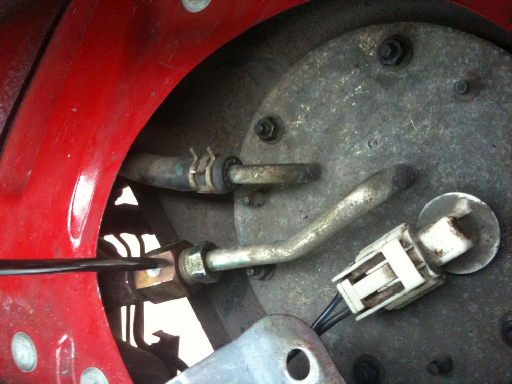

Second problem is fuel. He put another fuel pump on it while I was at his shop and I think he put the wrong assembly in because on the way home it was leaking gas bad out of the fitting (attached picture.) We had a mechanic at the gas station we stopped at and he torqued it but said it was the wrong flare for the fitting. I'm not sure if he's right. This is a huge problem that needs fixed ASAP! Any ideas?

2) Get the right flare fitting.
