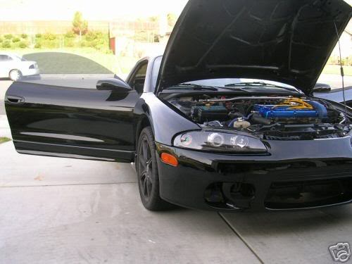

Off topic...
In your sig, remove all that other stuff and just put this code in..
Code:
..that way, you can have your sig in there. But you'll need to shrink it a bit also..it's too big.
