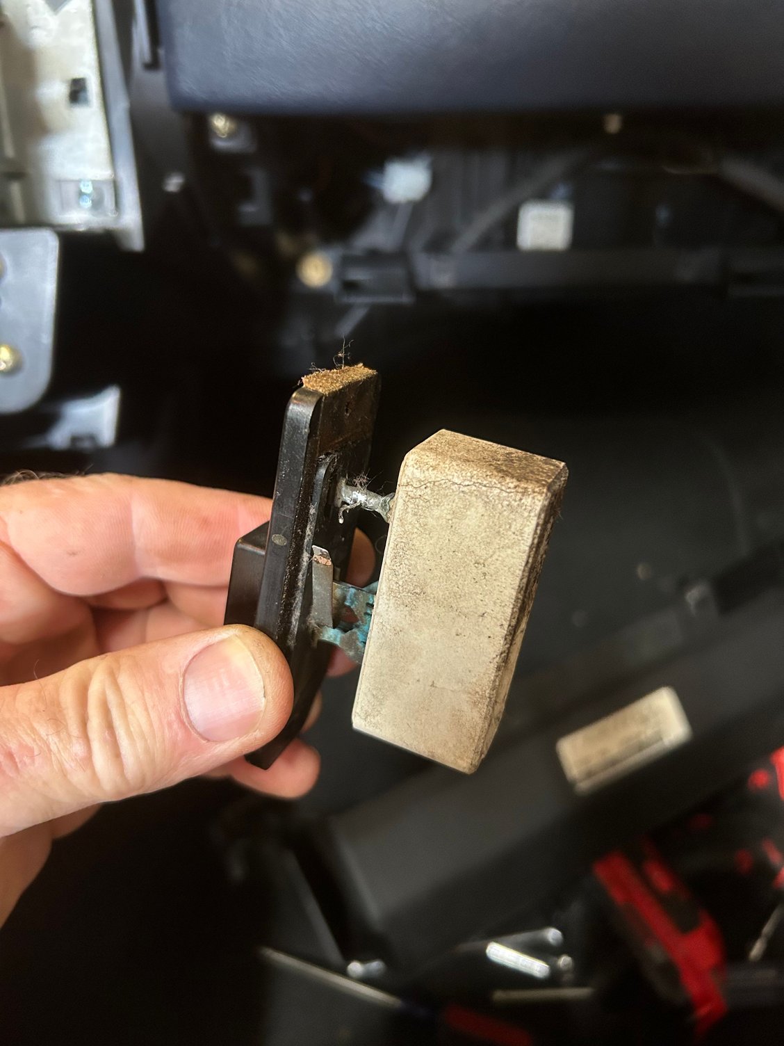

This doesn’t look right 🫣

As I keep working on this, I am learning about resistor blocks. I'd say this one is toast. I don't have the specs for the pins but the meter shows 0 Ohms on all pin connections I made except for one pair. I have ordered the new part.. be here this weekend. My question now is.. if the resistor block is the culprit, why doesn't the blower still work on High? And would this bad part keep the compressor from coming on? (No indicator light illumination when I push the AC to ON)
