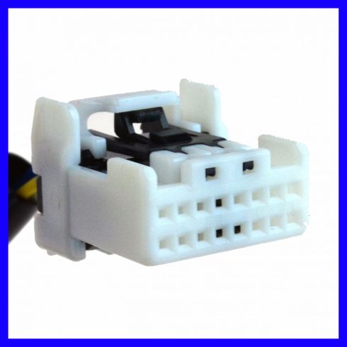

I'm trying to get the pins out of these harnesses for the side mirrors on my Mitsubishi Outlander. What is the trick here? I tried pushing a thin, sharp metal screwdriver into seemingly every hole and tugging, but they are in stuck in there well.
Does the white casing need to be removed first? Do these harnesses have a name? It says PBT-GP15 on the side, but that's the type of plastic used, I believe. Any help or tips are appreciated.

This is what the bottom looks like:

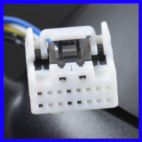

And the wire end of it:

If my memory serves me right (it's been some time), I just needed a smaller screw driver (almost the size of a needle, IIRC). That little screwdriver gets inserted into the back pin you want to remove and there is some location / latch that can get unlocked → the pin pulls out smoothly.
