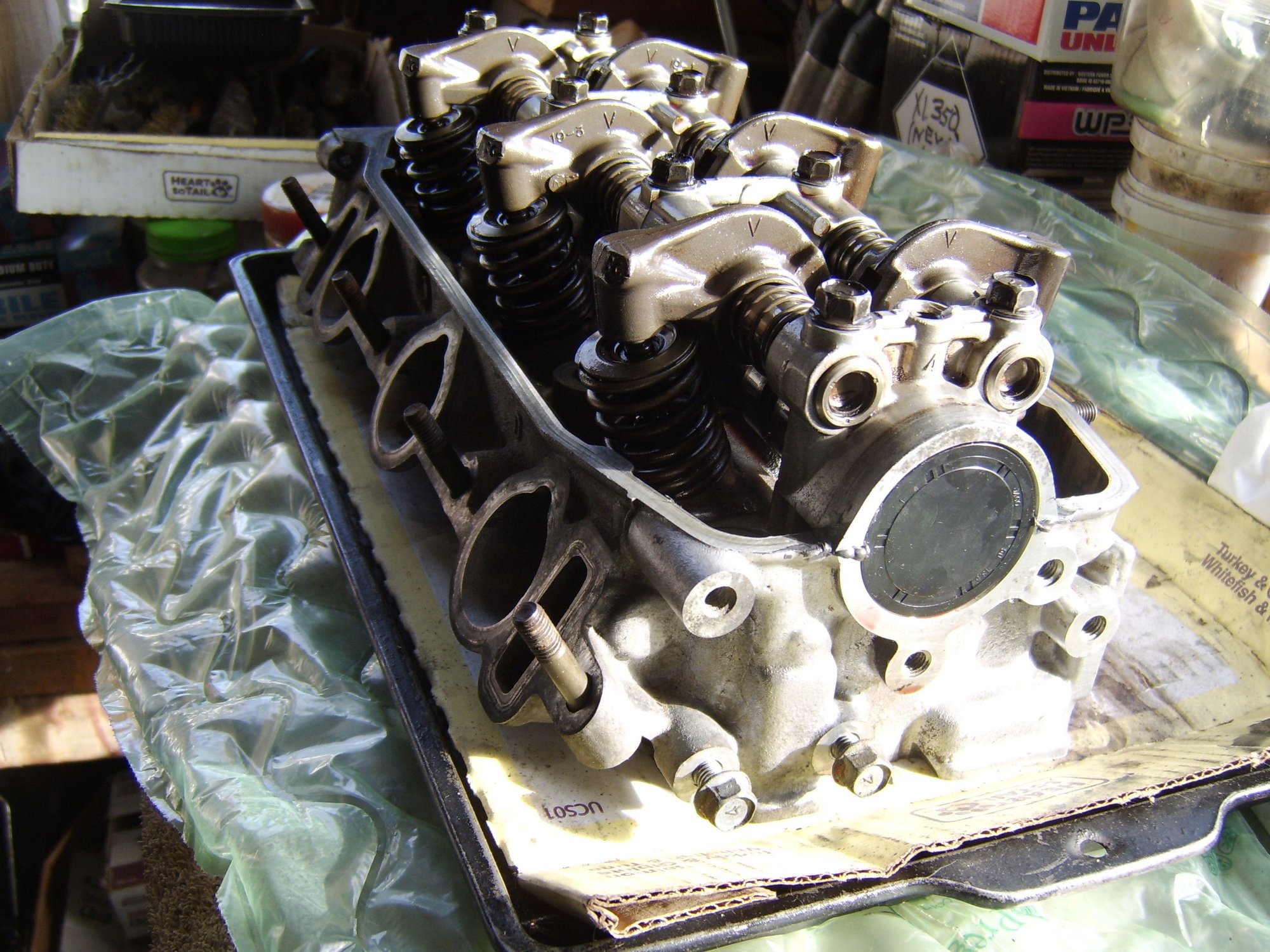

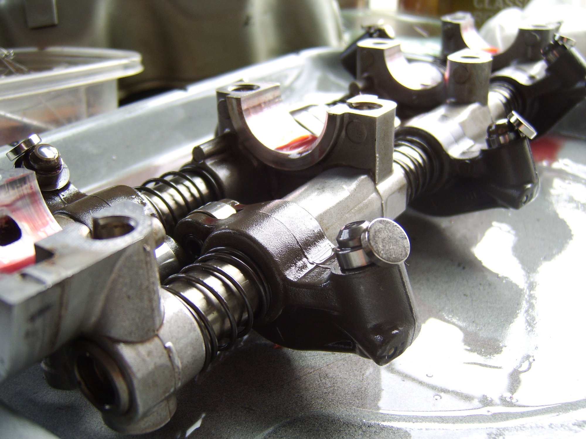

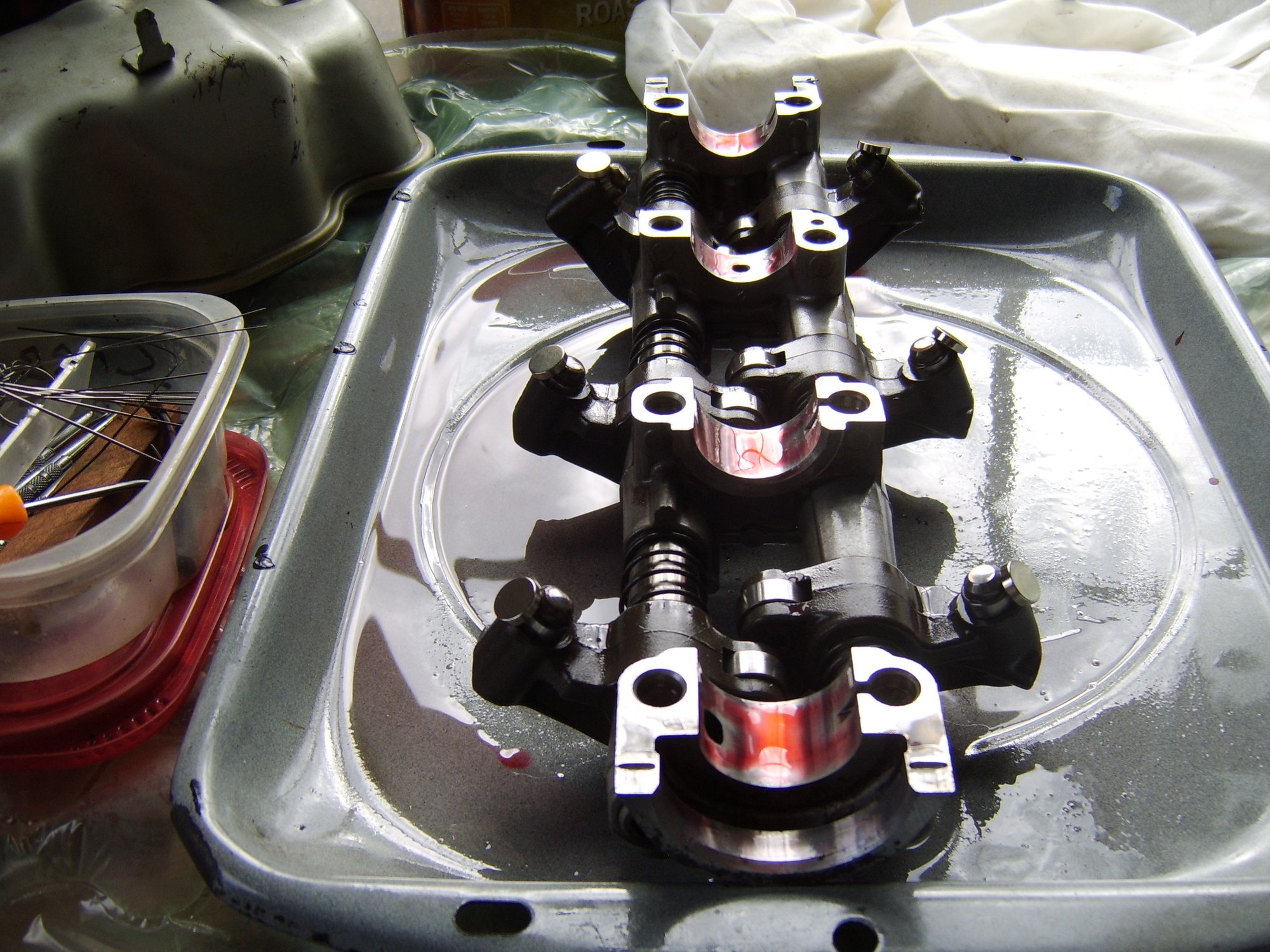

You may have a worn-out lifter surface. In the pic below, you can see the lifters that I have round magnets on to hold them in place as I rotate the assembly up-side-down to reassemble it on the head. The thin surface of the lifter can wear out and "burn thru" which will prevent the lifter from building up oil pressure inside and thus it will not expand as it should. Thus, you would have that clatter noise as a result of a worn-out lifter.
Pics from my 94 Montero while re-installing the lifters and camshaft back onto the head: I imagine your Colt is similar.....is it the 3.0?
Magnets holding the lifters from falling out when rotating:
Head ready to go back onto the engine:
