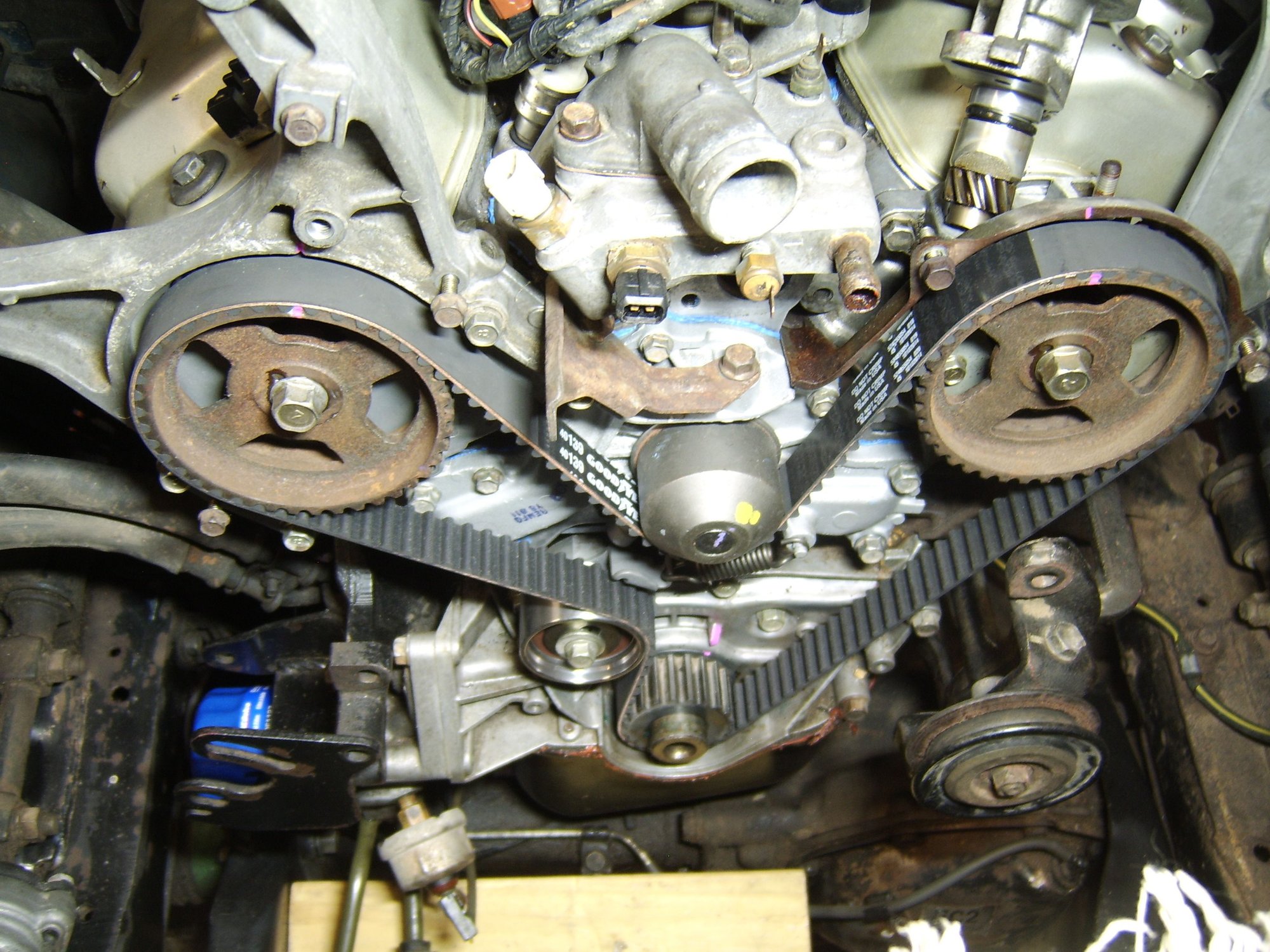

I suppose we both are legally insane......as we both own 4 Monteros......all of mine were 94s, and I did just sell one....so down to three.
I have replaced the head gaskets and timing belt and almost everything else in the 94 LS with the 3.0 V6......it definately has a timing belt, not a chain. You really should try to get shop manuals since you own several, and having the correct data is essential.
Here is a pic of the timing belt being installed on the 94 LS:
If you check my posts, you will see more information and pictures on installing the timing belt.

Haha si señor, 'cadenillas' are generally used in those bordellos. But they just send me a photo from a dismantled V6, and it looks exactly like your photo. Maybe they call these rubbers cadenillas over here, don't know Anyhow, they say this belt looks fine and can last another 25000. For now I believe them. (or maybe they're afraid to do the job)
