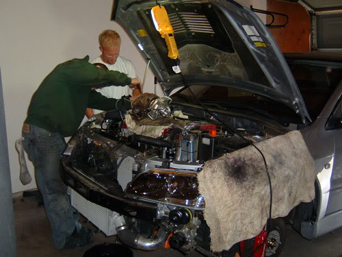

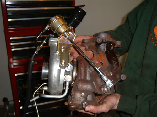

Okay, see the pictures below of the install.

My brothers and I were able to get the old turbo, O2 housing, and exhaust manifold off the car. We then took and replaced the cams with GSC S1's and while there installed the ARP Head studs. Next weekend I'll be installing the fuel pump, FP green turbo, injectors, and downpipe. Hopefully it will be running by the end of the day next weekend.

All the parts have been installed but I haven't been able to start the car yet. My brother put the wrong size bolt in the O2 housing and stripped the thread. Tomorrow morning I'm going to repair the problem and then should have it running. The only other incident was stripping off one of the studs the exhaust manifold bolts on to. I was torquing them down and one gave way. Does anybody know if you have to take the head in to get this fixed? I'm going to run it like it is for now; don't think there should be any trouble as long as the other bolts are torqued down correctly.

Bolts are fairly easy to tap out. All you need is a reverse thread bit, you drill a hole in the broken bolt, you hammber the bit into it, attach the drill, put it in reverse, and away you go.
