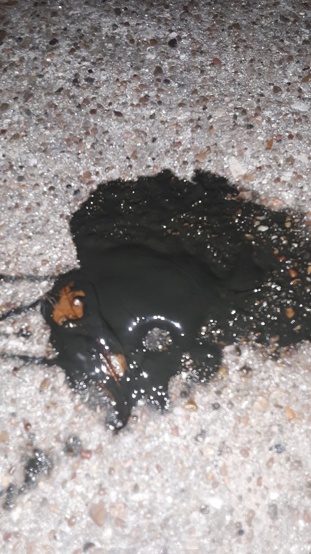

Have a funny grease drip that pops up on the driveway over night. I will try to post a pics in a bit. Its on the drivers side right behind the wheel control arms. It's not oil. It's kind of thick. I tried getting under there and looking for a grease trail. but I can't see anything.

That is the area where there is a single grease point on the full size Montero - front drive shaft to front differential U-joint. It's possible that it was over greased and that grease is falling out.

Disregard. It's coming from my wifes 12 rogue. Cut cv boot.
