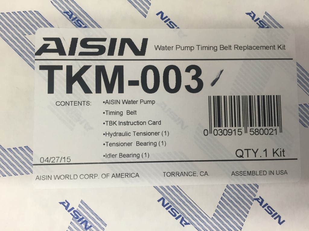

I bought the Aisin TKM003 for my 2002 3.5L from Rock Auto. I have not yet installed it but will be soon and will post it here https://mitsubishiforum.com/forum/mi...removal-48920/.
Rock Auto Link:
More Information for AISIN TKM003
The timing belt is made by Mitsuboshi which is not a typo. They are an OEM parts supplier. On another forum I frequent, a Mitsubishi service tech there recommended the Aisin kit and the Mitsuboshi belt.
Attached Thumbnails 01 Montero XLS 3.5L timing belt parts & temperature gauge-aisin-tkm-003-water-pump-timing-belt-kit.jpg   01 Montero XLS 3.5L timing belt parts & temperature gauge-aisin-tkm-003-water-pump-timing-belt-kit-packaging.jpg
