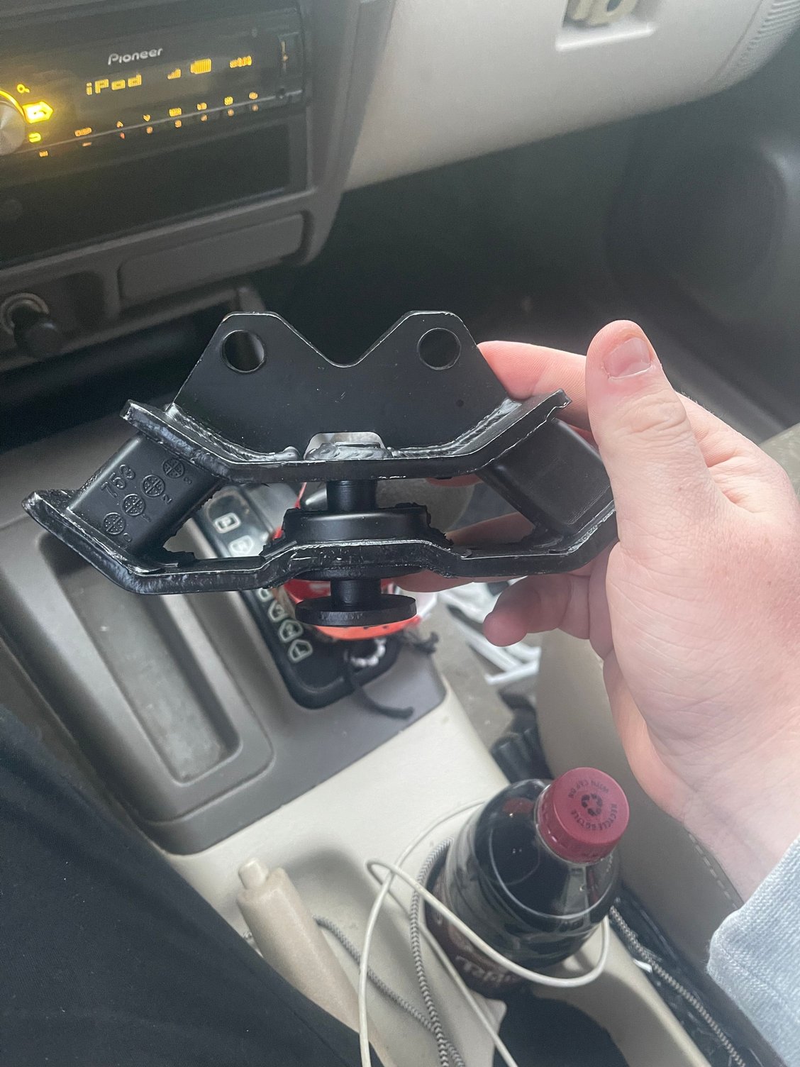

montero sport man's Avatar
Joined: Nov 2021
Posts: 14
Default transmission mount
I took a video of the trans mount and my moving it and i can tell there is a good amount of play in the bushing and i’m able to push it up with only 2 fingers. hopefully that mount is my vibration problem. they are only 23.99 lol @MikeE75

well that could be a thing. I had my transmission replace so I’d hope they replaced the bushing lol. Maybe that’s your problem. And for 30 bucks it’s better then yanking out the cv axle If you don’t need too.

Oh boy, when you replace that, you will notice a difference. Mine had some play not as bad as what you've described. Anytime I would lay on the gas from a stop I kinda felt like gears were slipping. Afterwards it was like I was driving a new car.

@Naeos_Valkarian i feel like mine is not terrible but i feel that me being able to move it w my fingers, (even though it takes force), should not be possible.

turns out it’s the driveshaft support mount that is shot on my unit
