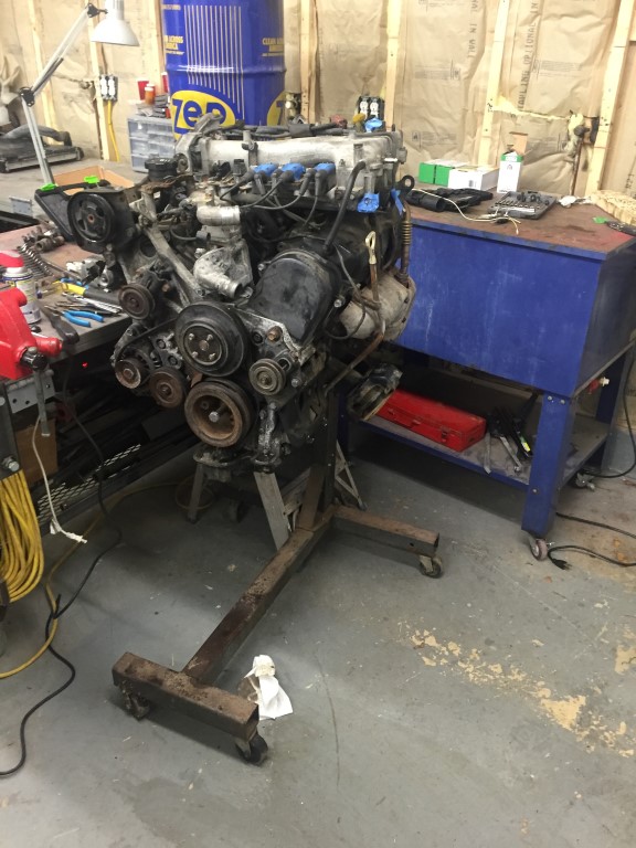

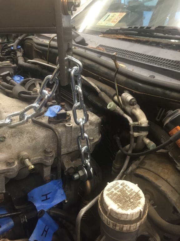

I finally got the engine pulled. 2002 Montero Sport 3.5L
To access the torque converter bolts, remove the drivers side exhaust crossover pipe as shown in the prior post. Then remove the bracket for the crossover pipe. Directly above this bracket is the access cover held in place by two bolts. Once removed, you can accces the torque converter bolts via extensions and swivels. There are 6 torque converter bolts which are 17mm.
Engine has brackets already for lifting. Front left pick point is by steering pump and right rear by cylinder head.
AC compressor was unbolted and left in vehicle still charged.
Attached Thumbnails 2002 montero engine removal-troque-converter-bolts-access-cover.jpg   2002 montero engine removal-torque-converter-access-cover-removed.jpg   2002 montero engine removal-back-3.5l-engine.jpg   2002 montero engine removal-engine-front-left-pick-point.jpg   2002 montero engine removal-engine-right-rear-pick-point.jpg
2002 montero engine removal-engine-pick.jpg   2002 montero engine removal-engine-stand.jpg
