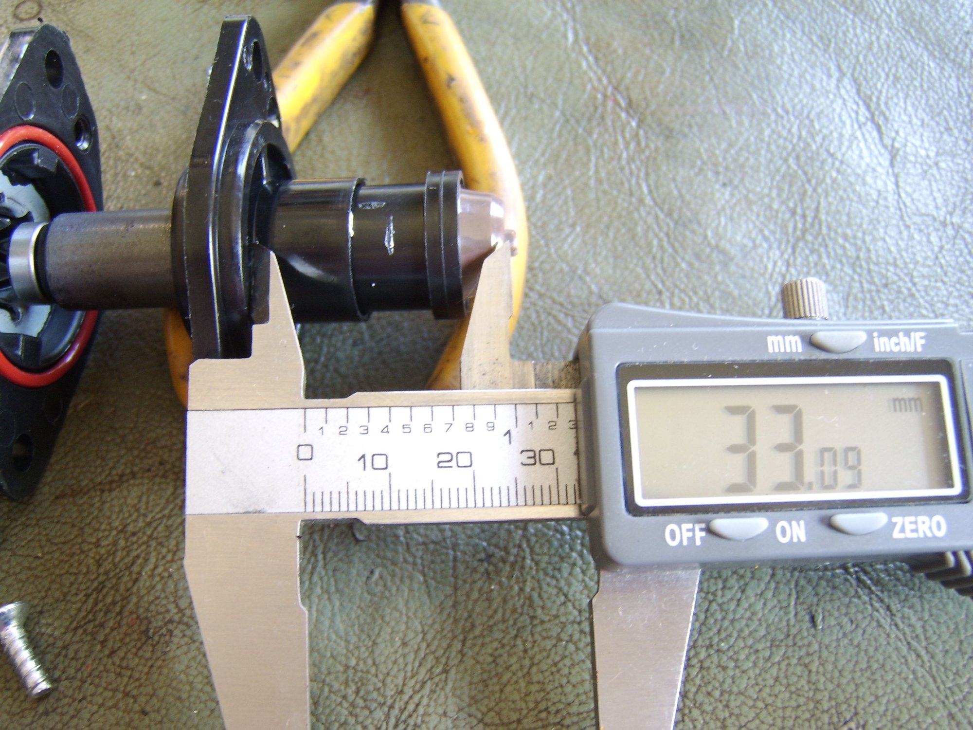

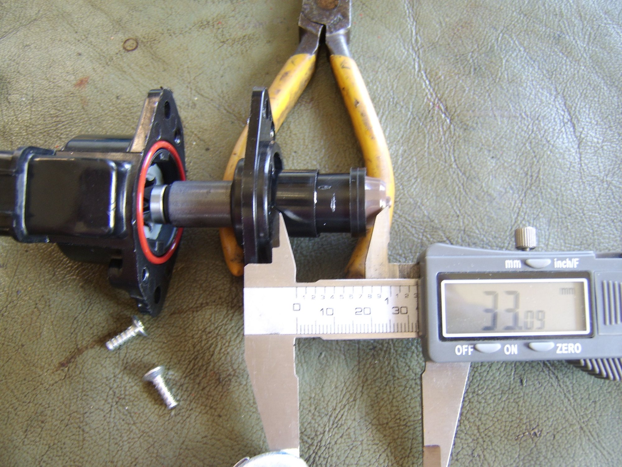

Well, I thought I would try disassembling the new knock-off IAC and see if the shaft was adjustable like the OEM unit. This new one only had 2 phillips screws that held the unit together. After removing them, it pulled apart with no problems. I rotated the shaft, and it did actually allow the end to stick out further. So, I twisted it a few times until it was about 33mm in lenght, which increased its length by about 4mm.....from 29 to 33mm. See pic:
I tried to measure the depth of the hole which the IAC slides into, and it was about 29mm to where the inner port would begin to touch the tip of the IAC.
I thought that surely this would solve the high idle problem. Took the Monty out for a test drive, and the idle still would not drop below 1,250 (unless I came to a stop with the tranny in Drive, and it would drop to 1,000 RPM). So, this is still too high. I suppose I could try twisting the IAC all the way out and give that a try, but am doubtful that it will solve the problem.

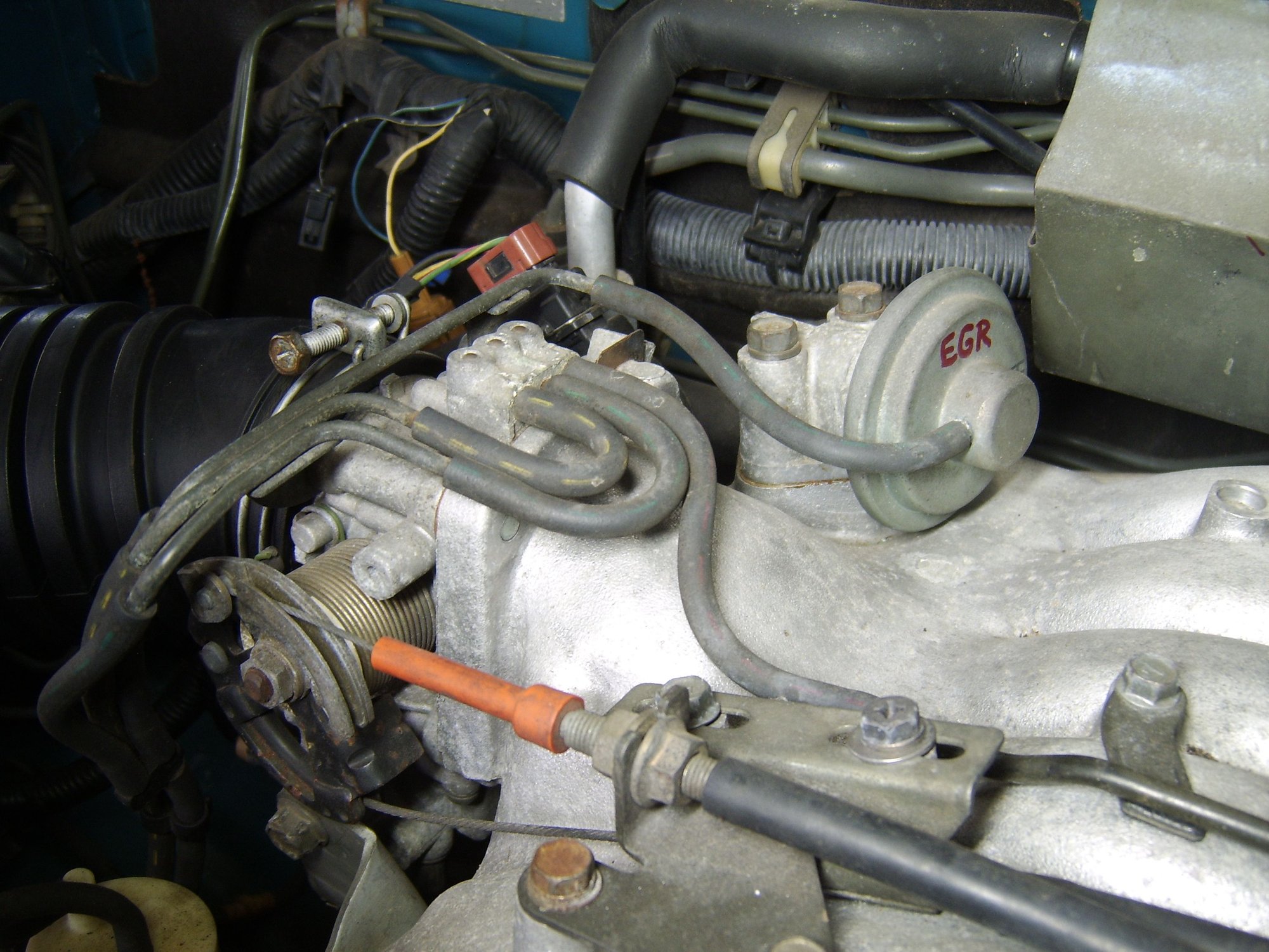

Guess I will have to remove the throttle body and see if I can find some other issue. In this picture, there is another sensor on the back side of the throttle body.....I guess this is the throttle position sensor? Maybe this sensor is bad?
Sensor mounted to the left of throttle body is "throttle position sensor"?"

Old Aug 2, 2020 | 09:56 AM
StudebeckerHawk, we can eliminate the gasket on TB. I can see the tab on it in the last photo - it is installed correctly. Your vacuum hoses are routed differently than a newer on the newer model, do I can't confirm visually the all is in the rift place. Looks correct by the shape of the codes and pipes. Before pulling throttle body... Did you have a chance to check EGR valve? Engine with stuck open EGR will rum OK, but will not hold idle.

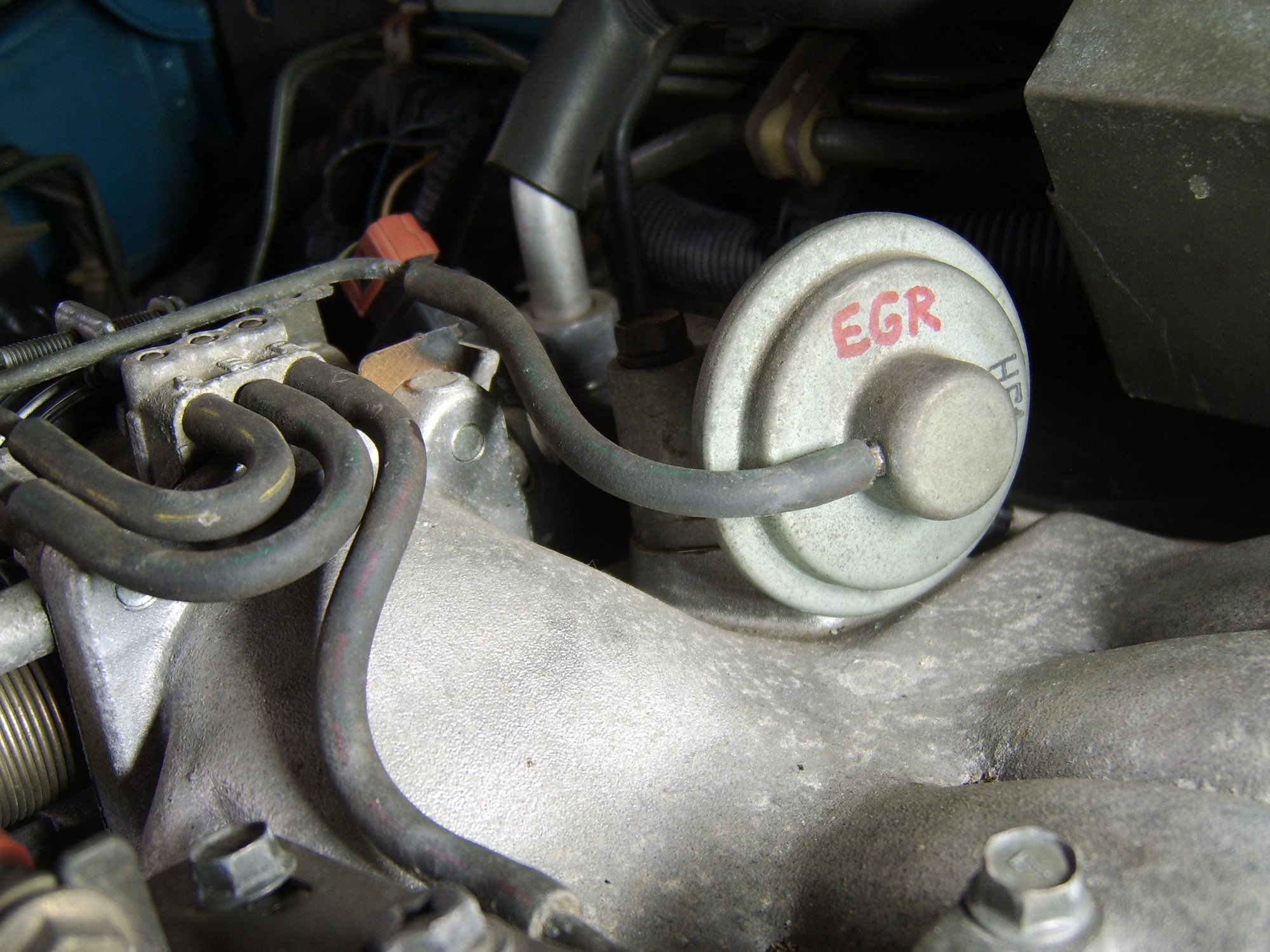

Hunter.......Thats a great tip.....the EGR valve. Here is a pic of the engine, and then detailed pics of the EGR:
EGR Valve:
Other side of EGR:
I checked in the Shop Manual, and it is confusing.....they showed the EGR being located way over near the brake resevoir, mounted to the battery holder.....I guess they goofed, and that was for the other engine. So, I will remove the EGR and also the throttle body to give it all a good cleaning. Could be you hit the nail on the head with this EGR postulation..........
Will get back after I have time to tear into it this week.
